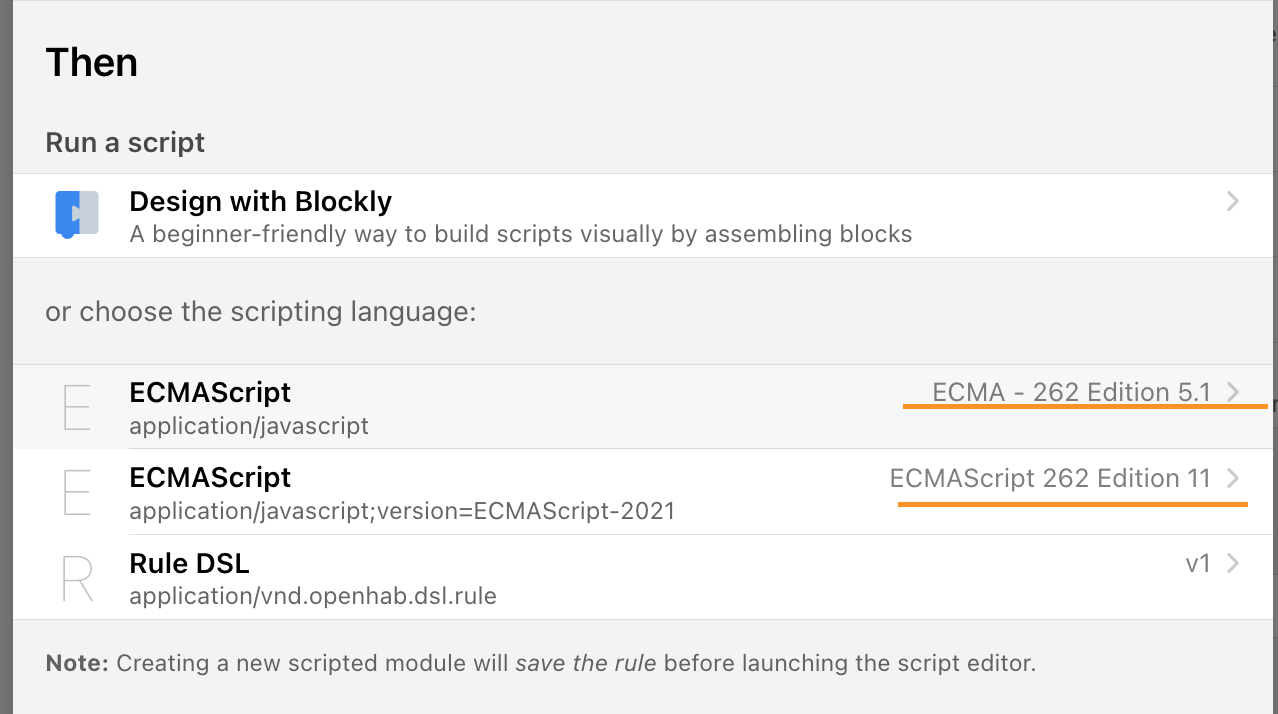

Which one? 5.1 or 2021?
Its OH 3.2. So I think 2021
It tells you.
You have to install a separate add-on for 2021.
