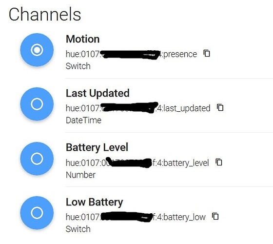

I have added my Hue bridge with the Paper UI Inbox and the motion sensor, too.
I can read the presence and battery for example, but the light sensor does not appear in the sensor “thing”.
Is it not supported and can i add it manually in the things file, even if I added the sensor initially with the UI?

If I remember correctly the support was added recently, so you need to upgrade the hue binding to the latest.

Sorry, I should have been more precise: you may need the latest hue snapshot binding (or the one from the milestone)
Sure: delete the binding in PaperUI, download the hue binding snapshot jar, put it in your addons folder.
You may need to restart openHAB or even clear tmp and cache folders to make it work.
Also you may need to manually install esh-io-transport-upnp:
That works!
But i had to delete the old hue bridge thing, too and re-add it from inbox.
Now i have all sensors.
Great! Thank you. :slight_smile:
Yes, forget to mention this: if the channels for any bindings change, you have to delete the thing and readd it again to pick up the changes.
