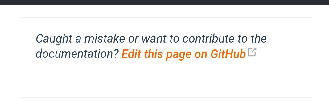

I did not look at two different and i was following by from Mail - Bindings | openHAB someone need fix that one for openhab mail binding at https://www.openhab.org/addons/bindings
link to edit
You do know that someone could be you? :wink:
