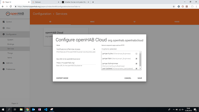

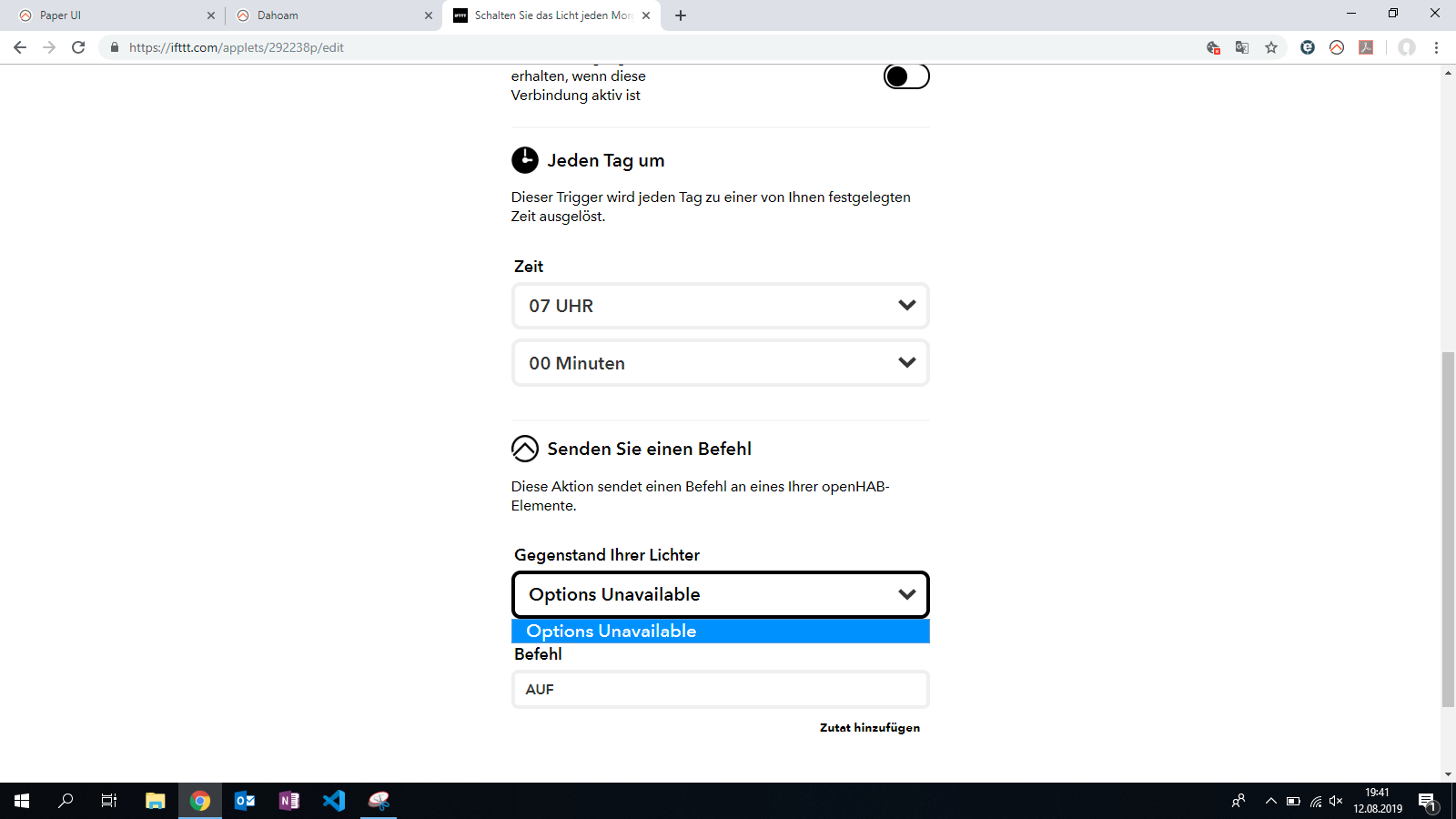

I have installed the openHAB Cloud Connector and want to add ifttt to this cloud but it says it it is unvailable. My openHAB Account is with ifttt connected.
I have activated the items to ifttt.

IFTTT Cloud support has been temporarily disable doe to server load issues.
@digitaldan is the man with the plan. :smiley:
IFTTT is currently disabled due to excessive load on our myopenHAB servers. No eta currently for when it will be back again.
