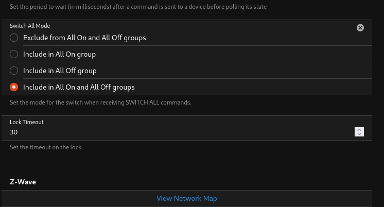

  4. Also on the UI page do you have the controller in the association groups 2 or 3, if yes remove.
I did…and done

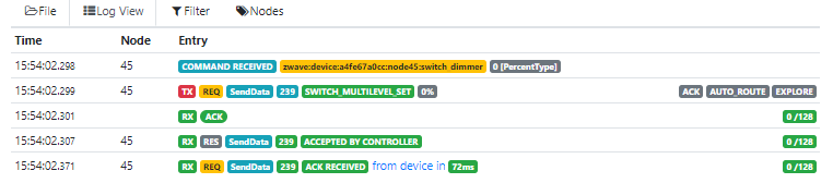

This is the snippet in the log viewer. It actually looks fine (no command poll yet - right?). Maybe it is the device?

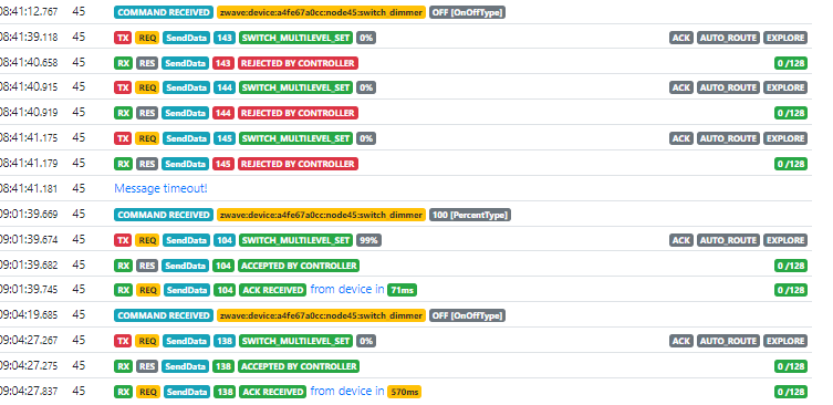

edit: 72ms is pretty good response; From your big file this is an extract of node 45. One completely rejected because the controller was busy. One ok and one kinda slow 570 ms.
Command poll was off for this device. I decided to test it on another switch (Same model) and the behavior is consistent. I can (via UI) turn the switch on and off multiple times until finally, the command doesn’t register. But then if I hit the UI control a few more times, it continues to turn back on and off. It is only the GE dimmers as I said though. So I don’t think its an issue with the individual switch so much as the GE dimmers. I vaguely remember they had strange behavior in Homeseer as well but I was able to get them working via a workaround.
I think, if anything, this validates my desire to replace these specifically.
To me this tends to confirm that the root cause of this behavior is network congestion related. As congestion can be caused by any/all the devices, my suggestions above regarding the Zooz devices and rule timing could help (without an investment in new devices).

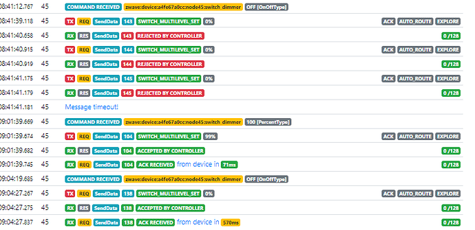

Also, I realized that Node 6 has never failed (its my office so the room I’m sitting in often when testing). I can trigger the light over and over again without any failure. Its the exact same type of dimmer as the ones that fail. The settings themselves are all the same. I found something very odd though on the Thing configuration page. This is Node 6:
This is Node 8:
Only Node 6 has that Lock Timeout option (which I don’t believe it should have) and it is the only switch of that type to be working properly.

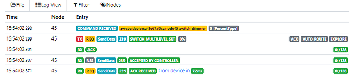

Just as an additional data point : I can send any command of 1% - 100% to these switches and they will work every single time. The ONLY command that does not work every time is OFF or 0%.
Interesting. Possible work around if 1% looks off? Maybe only for the ones that don’t always work?
Log is much better, although I think spacing the OFF commands will help also. Two nodes seem problematic. Node 13 sends a lot of updates. Is the controller in the other Association groups? Node 47 jams things up because it doesn’t respond. Is it remote from the controller? Could you test w/o it and see if it helps.
Can’t explain the lock Timeout- seems misplaced as not a lock device. Did you have a lock as Node 6 sometime in the past? I think the closeness to controller is also an explanation.
