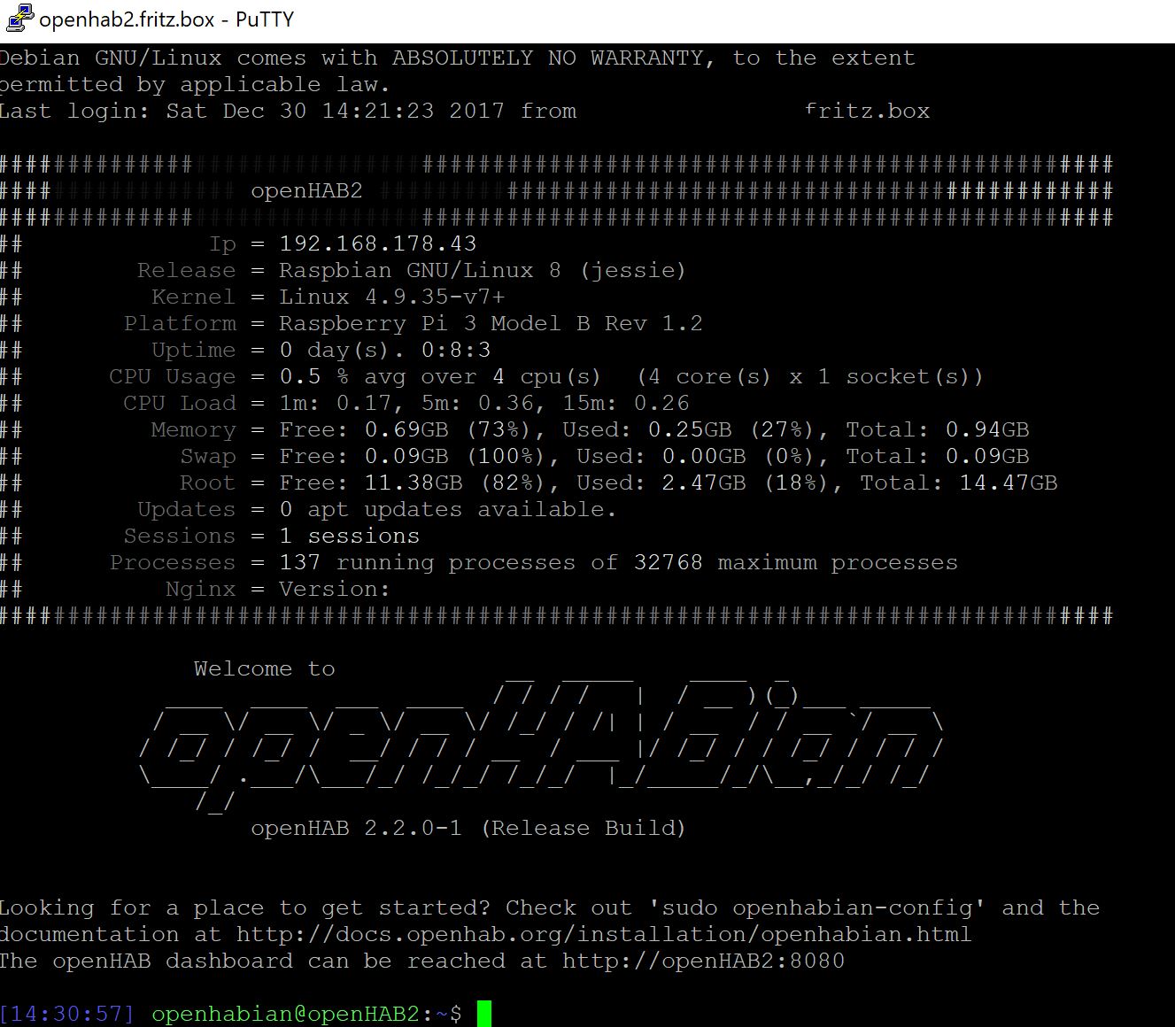

My installation:
openhab2_issue3
Any idea how I can fix it or at least any idea what could be the cause? I appreciate your insights…
