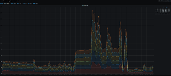

I know this is an old thread, but it seems I had a serious memory leak (and high CPU usage) caused by the IPCamera binding after upgrade to OH 3.2 .
The binding was installed but not used, however after the upgrade to 3.2, OH used much more CPU and froze after some time. Some “Out of heap space” error message were in logfile.
I found this thread, removed the IPCamera binding (and deleted remaining Items that linked to non-existing IPCamera things) and the problem was gone.
On the screenshot you can see the CPU load after Upgrade to 3.2 (13.12. evening), an even higher load before complete freeze, low CPU load after freeze, and new low CPU load after removing IPCamera binding (27.12.).
