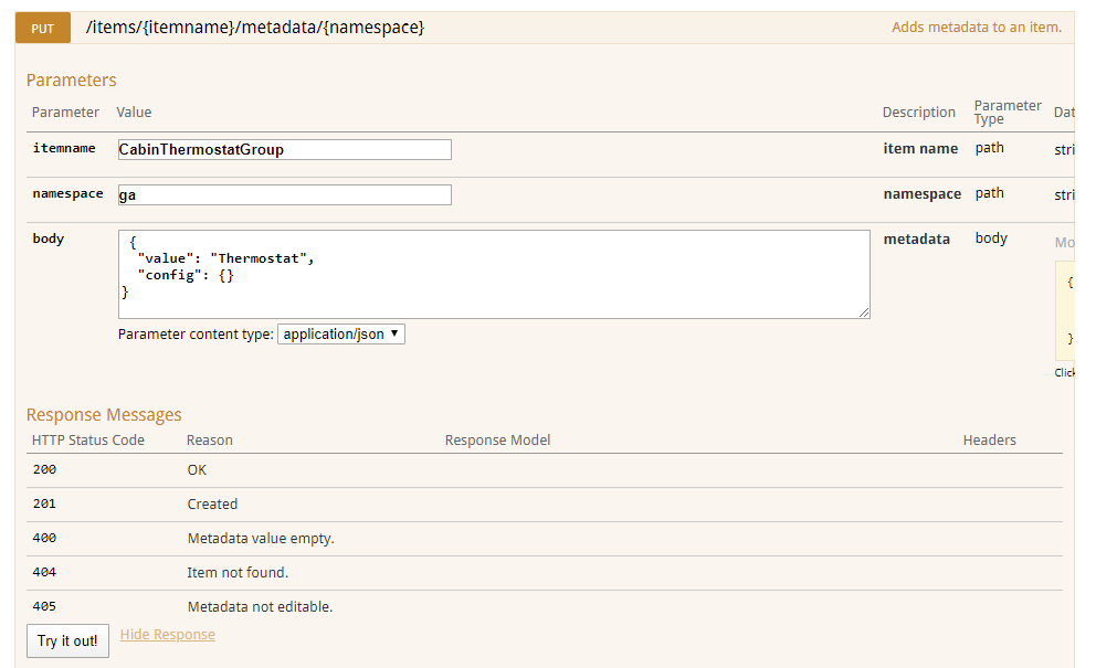

Added the following Metadata to the Thermostat Group Item in RestAPI
namespace = ga
body =
  "value": "Thermostat",
  "config": {}

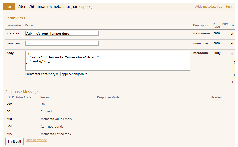

Added the following Metadata to the Current Temperature Item
namespace = ga
body =
  "value": "thermostatTemperatureAmbient",
  "config": {}

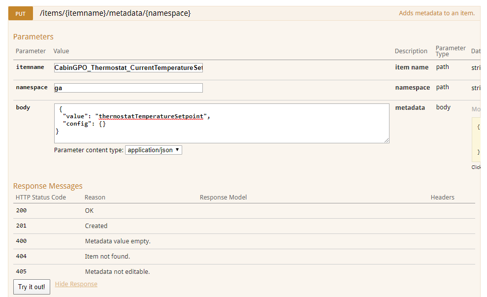

Added the following Metadata to the Current Target (Setpoint) Temperature Item
namespace = ga
body =
  "value": "thermostatTemperatureSetpoint",
  "config": {}

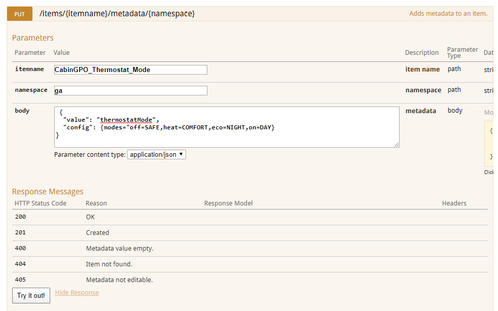

Added the following Metadata to the Thermostat Mode Item
namespace = ga
body =
      "value": "thermostatMode",
      "config": {}
Also tried defining the Mode names like this for a Velbus Thermostat
namespace = ga
body =
      "config": {modes="off=SAFE,heat=COMFORT,eco=NIGHT,on=DAY"}

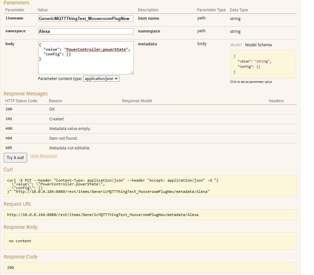

I’m trying to add Alexa metadata to an item created in Paper UI using REST API. I have succeeded in adding Alexa Metadata to an Item created in a .items file, but am I having trouble doing it with the REST API.
I get a Response Code 200 (OK), but when I have Alexa search for new devices, nothing shows up.
Any ideas?
try to write alexa in small letters; alexa
Thanks. That was easy. With lower case the return code is 201 (Created), and Alexa recognized the new device.
