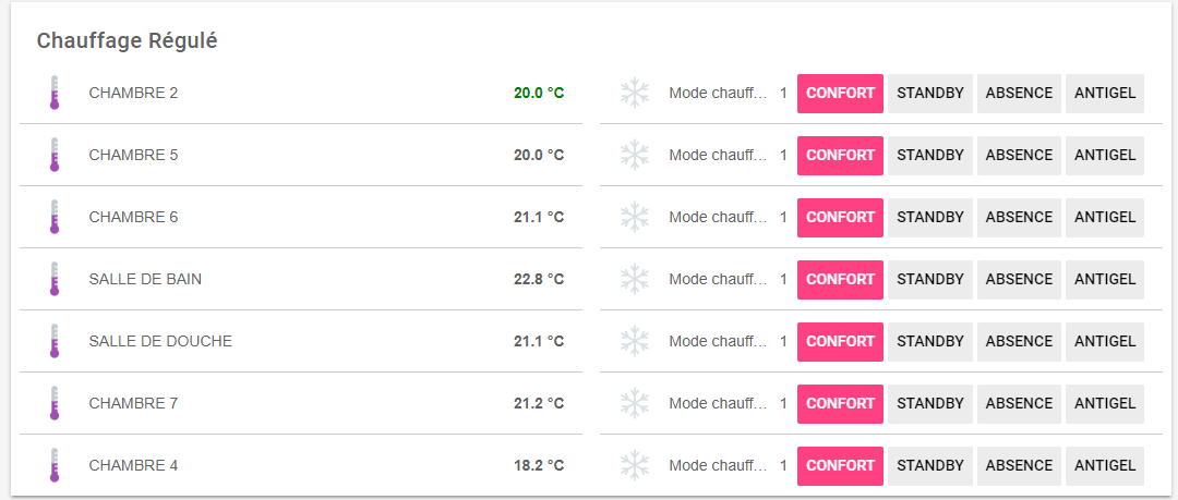

I’m trying to configure my floor heating system from Merten to have something like this
It was working fine with KNX1 but I’m a little lost in the migration steps to KNX2. So any help to configure this in KNX2 will be appreciate

What is wrong in this config? Do you have any suggestion?
