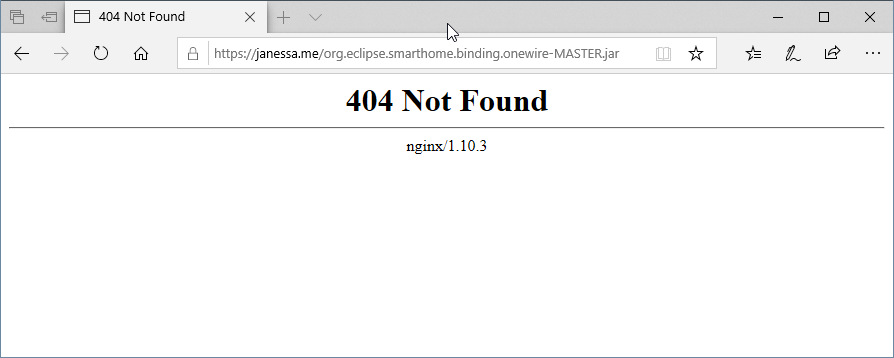

Could you provide another link as this one is not valid?
Just select “Latest OneWire Master build”.
Nothing is there. Please find screenshot.
Maybe issue with permission?
Really interesting. The link pointed to “org.eclipse.smarthome.binding.onewire-MASTER.jar” which resolved for me to “https://janessa.me/esh/org.eclipse.smarthome.binding.onewire-MASTER.jar”. I’m not sure why you miss the “/esh” part. I have made more explicit links now.
