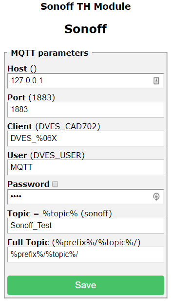

My test device is a Sonoff TH16 with Si7021 temperature sensor that’s been reprogrammed with Tasmota firmware. The Sonoff seems to be working just fine, I can log into it via my web browser, screen shot of the MQTT configuration below.
The Sonoff isn’t connecting to the MQTT broker; the blue indicator light continues to flash and the log reading:
“19:48:55 MQT: Connect failed to 127.0.0.1:1883, rc -2. Retry in 10 sec”
continues to log.
Question: Is 127.0.0.0 the correct connection address? I don’t see this setting in the MQTT broker.
You need to set the Host to the IP of the system where the broker is running. Setting it to 127.0.0.1 means localhost, in your case that would be the Sonoff-Device!!
127.0.0.1 = loclhost = the network card you are using right now…
ifconfig will show your IP(you need the IP of your broker , the same machine runing MQTT)
try to watch some basic networking youtubes, its the basic for home auto…
Ok, great news. Entering the appropriate IP address of my host computer did the trick. I can see the Sonoff is connected by using MQTT.fx. One step down!

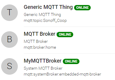

  1. Under Services/MQTT I have MQTT Embedded Broker and MQTT system broker connections installed. The only field filled under the embedded broker is the name of the persistence file (mqttembedded.bin).
  2. The following things are installed:
    The first is a thing that I tried installing via PaperUI, but am now unable to install (when I try I get Error: 409 - Conflict).
    The MQTT Broker configuration settings are:
  • Broker Hostname/IP: 127.0.0.1
  • Broker Port: 1883
  • Client ID: paho51621326352350 (system generated)
And that’s all that I can see. I was “hoping” to find some conflict but I can’t find any differences from online guides.
