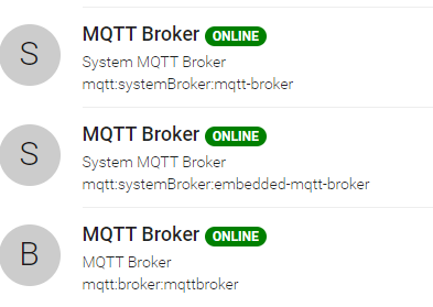

At any rate, I was offered two things to add and added them both. They’re both named “MQTT Broker,” one is “mqtt:systemBroker:mqtt-broker” and the other is “mqtt:systemBroker:embedded-mqtt-broker.” Do I need them both?
Since this setup seems happy, I’m going to try to forego the .things file that sets my bridge; are there some examples of how to define channels w/in the binding?
Thanks again!
Craziness. I reloaded my original .things file, and it’s all running like a champ. Of course I now have three broker things and I kind of nervous about deleting anything…
