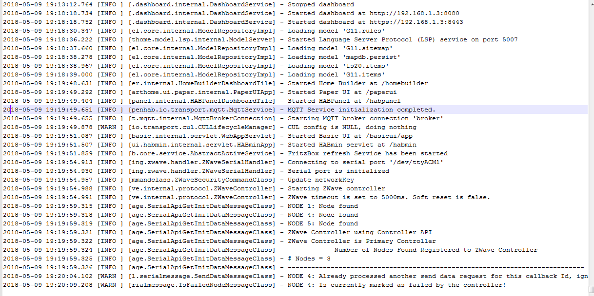

I think it is done !!!
Deleted content of these tmp and cache folders
and realized by the way that the system is building an additioanl file mqtt.config with this content:
So the Openhab.log is now quite clean and shows me only two lines for MQTT.
I assume this is correct?

42
Yes this is correct
Now on your tasmota:
Benutzer: openhab
Passwort: openhabian
Restart it

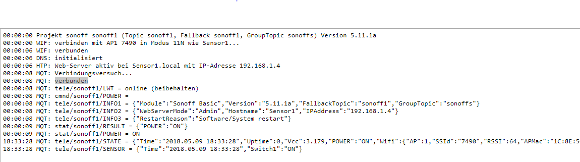

boris03
(Boris)
May 9, 2018, 5:38pm
43
says connected (verbunden)
