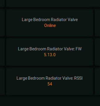

For the tasmota devices in particular, the broker will issue a LWT message (Last Will and Testament) when they disconnect.
I use that to monitor if they are online:
Example:
String LargeBedroom_RadiatorValve_OnlineStatus { mqtt="<[mybroker:tele/LargeBedroom_RadiatorValve/LWT:state:default]" }
Screenshot:

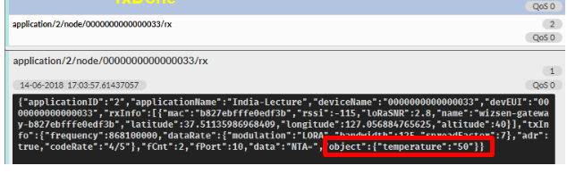

What is this for? I have a similar doubt, I need to extract temperature value from a string data that consists of other information, Can I use the above code to do that.
My data that I subcribe from mqtt looks like the screenshot attached below
Could you copy and post that json, please and I can tell you how to get the data you want out of it
Okay so i tried doing it but it wasn’t happening.
Below is the json data i subscribe, The data i need is object adc
