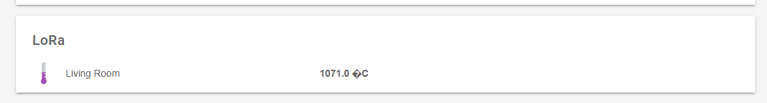

Number home_temp "Living Room [%.1f °C]" <temperature> {mqtt="<[mosquitto:application/2/node/0000000000000013/rx:state:JSONPATH($.object.adc)]"}
Cool that works!
Now are you sure that this is a temperature?
No temperature is not being sent, But Thank you , couldn’t have done it without your help
