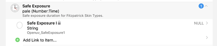

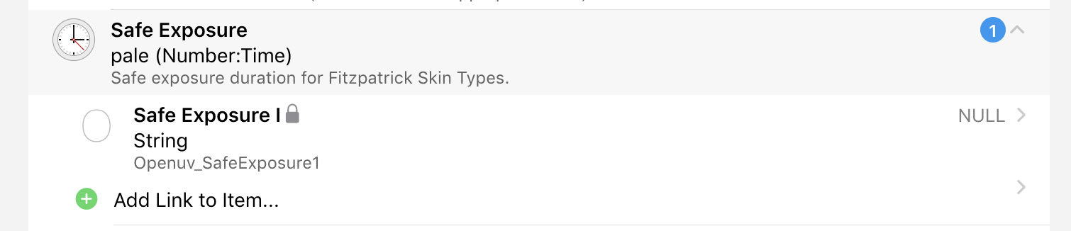

From what I see, it seems the channel in openuv.things is still using “number:time” scheme, instead of string:
mmm… when this change has been merged? I’m on 3.0.1
Just to try and ensure it works, so you’ll have the YAML version, it will help you check the thing file syntax
Sorry, just to be sure I understood correctly, idea is to remove the channels from the file and auto-discover?
Yes, remove the channels from your file and expand the thing with new channels (it’s not auto discoverable) : open the thing, and search “add channel”
where I can “add channel”?
On the other hand, I see also the “master” Safe Exposure as Number:Time, and not String :frowning:
Yes, the channel value is a Number:Time, but its configuration parameter is a String. But wait, maybe you’re not in the last binding version, expandable channels have been added recently.

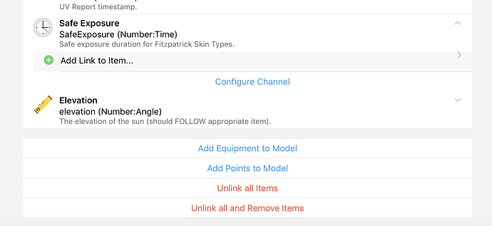

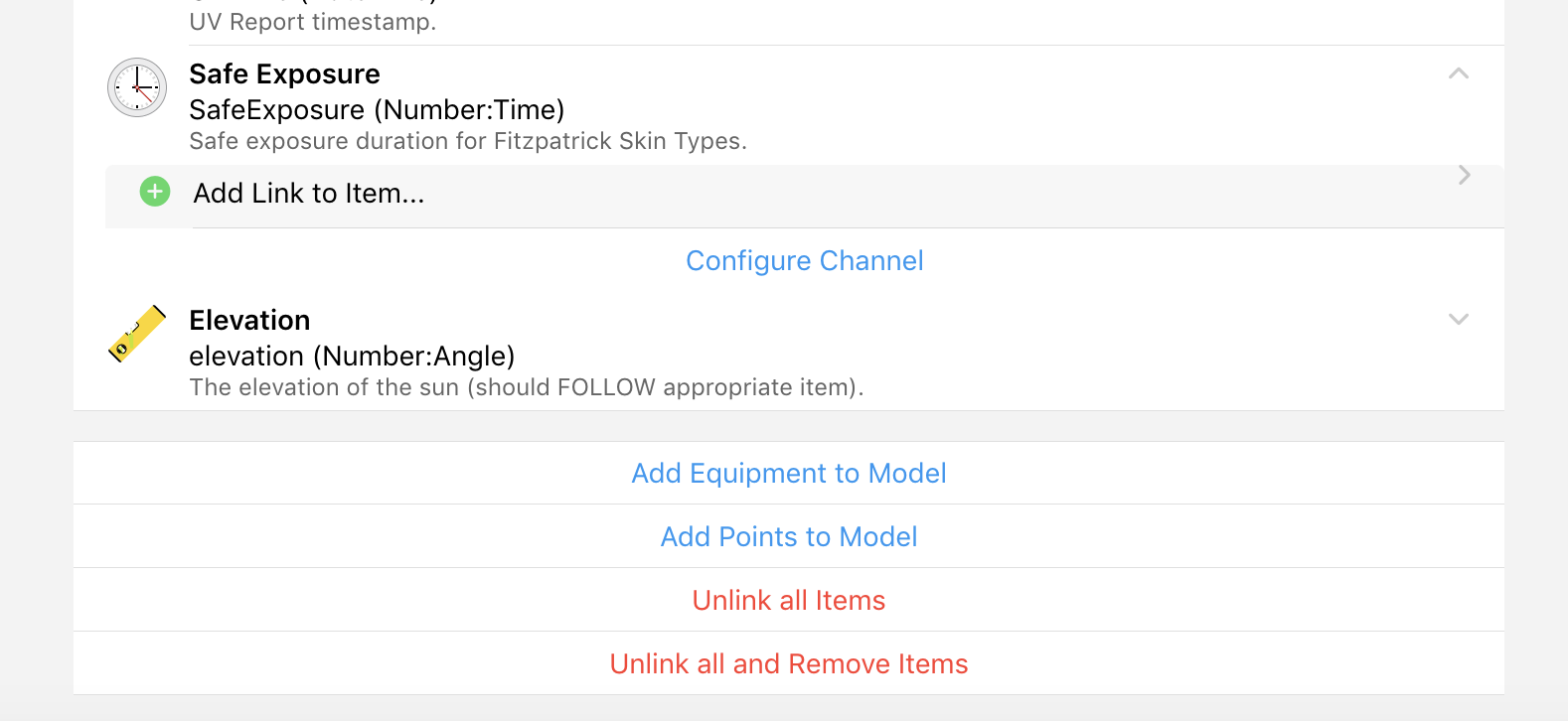

I’ve moved to 3.1, but not seeing any “expandable channel”
What I should see?
You should see something like that (note “Add channel” at the bottom of the screenshot) :
It gives you this YAML :
