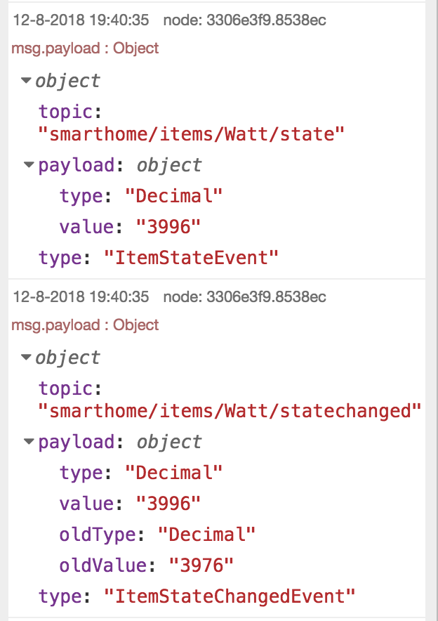

thank you, i tried out but i just get these informations into the debug log:
12.8.2018, 19:20:54node: 2794de80.8ed80a
msg.payload : Object
object
topic: "smarthome/items/Tado_zone_Wohnzimmer_Humidity/state"
payload: object
type: "Decimal"
value: "54.90"
type: "ItemStateEvent"

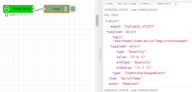

Je zou 2 messages moeten krijgen een ItemStateEvent en een ItemStateChangedEvent. Het ItemStateChanged event heeft in de payload een value en een oldvalue.
Dus capture de itemstatechangevent ipv de ItemStateEvent die je nu bekijkt.
Zie screenshot hieronder

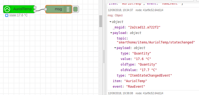

The oldValue is available in the second output of the openhab node:
thanks for your help! just learned, that the oldValue is only avaible, if the value really changed. thats the reason why i didnt see it.

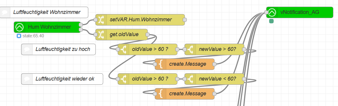

for everyone thats interested in: this is the example rule “translated” to node red.

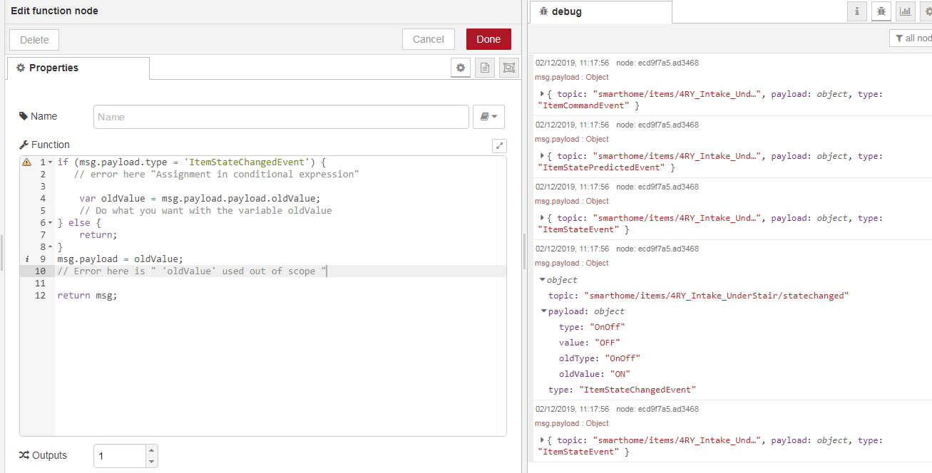

Hi

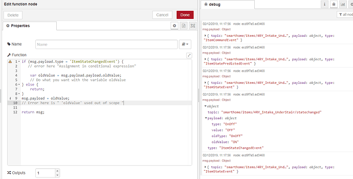

Where am I supposed to put that code?
If I put it in a Function node, it throws errors.
If I put it in an expression of a Change node, not a lot happens other than lots of red makers.
What’s really annoying is that I can see a Topic with ItemStateChangedEvent, but how do I simply move that to the main payload?
02/12/2019, 11:17:56[node: ecd9f7a5.ad3468](http://192.168.178.42:1880/#)msg.payload : Object
object
topic: "smarthome/items/4RY_Intake_UnderStair/statechanged"
payload: object
type: "OnOff"
value: "OFF"
oldType: "OnOff"
oldValue: "ON"
type: "ItemStateChangedEvent"
@e36Alex has done it with a change node, but I just can’t work out how.

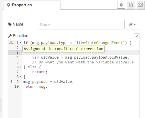

Try that:
if (msg.type = 'ItemStateChangedEvent') {
    var oldValue = msg.payload.payload.oldValue;
    // Do what you want with the variable oldValue
} else {
    return;
msg.payload = oldValue;
return msg;
When I paste it into a Function node, it instantly shows this “Assignment in conditional expression” error
and “oldValue used out of scope”

No… Nothing on the output..
However…

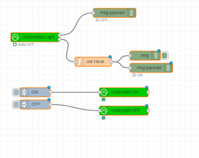

This does work…
Contents of Function Node
var oldValue;
if (msg.payload.type == 'ItemStateChangedEvent') {
} else {
    return;
return msg;
NodeRed flow

Thanks for your perseverance, It’s certainly something I would not have been able to work out.
So it is almost like my first attempts except that I had the scope of the variable wrong.
