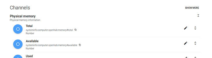

I agree with Vincent, that looks wrong for a Channel name. Chanel names are usually all lower case and consist of several fields separated by a colon.
From where in PaperUI did you copy from? That does not look like a Channel but an Item. You will find the Channels under the Configurations → Things → Specific Thing
