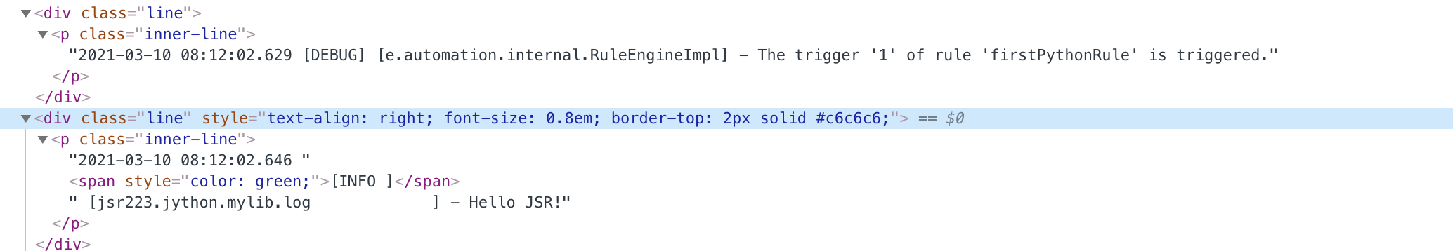

For the sake of completeness (I don’t think it really is an issue and not related to the code but rather strange) it then appears as well but with very small letters and very much indented in frontail, so it works but I am not sure why with a different font
It seems that “something” is adding a style to the log output
However it is is not reflected in the normal log (see below), so there is “something” in the log that makes it appear differently in frontail :man_shrugging: but nothing necessarily to be investigated (at least here)
2021-03-10 08:15:35.798 [DEBUG] [e.automation.internal.RuleEngineImpl] - The trigger '1' of rule 'firstPythonRule' is triggered.
2021-03-10 08:15:35.811 [INFO ] [.openhab.core.model.script.mylib.log] - Hello World!
2021-03-10 08:15:35.817 [INFO ] [jsr223.jython.mylib.log             ] - Hello JSR!
2021-03-10 08:15:35.818 [DEBUG] [e.automation.internal.RuleEngineImpl] - The rule 'firstPythonRule' is executed.
