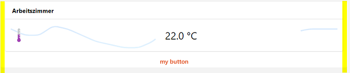

i’d like ot extend the layout of this card with
  • Buttons to change the temperature
  • Buttons to switch the heating mode of the radiator
so something like this:

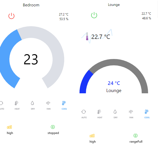

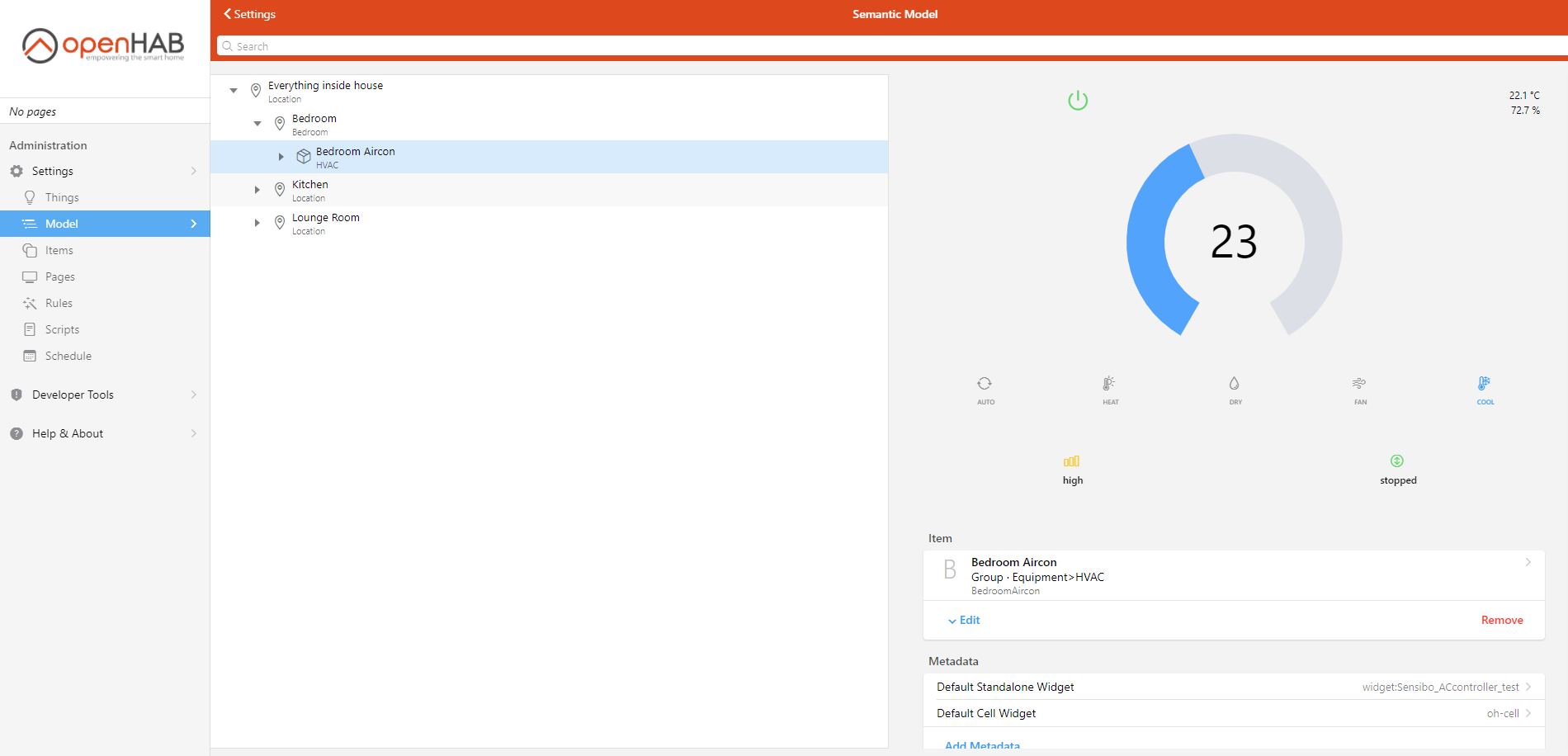

Yes you can I am still playing around with an aircon widget
I using a binding that has set values for items if you create them all using a model so if you set it as a default widget for your thing you don’t need to enter any values into the prams to get it working. Also currently if you push on the temp button it will bring up analyser.
Yes it is a cool 27deg in bed room without the aircon on
Here is a the code for the one on the right.
Most of this is copied from others on the forum and yes it is ugly 290 lines and probably is full of stuff you don’t need.

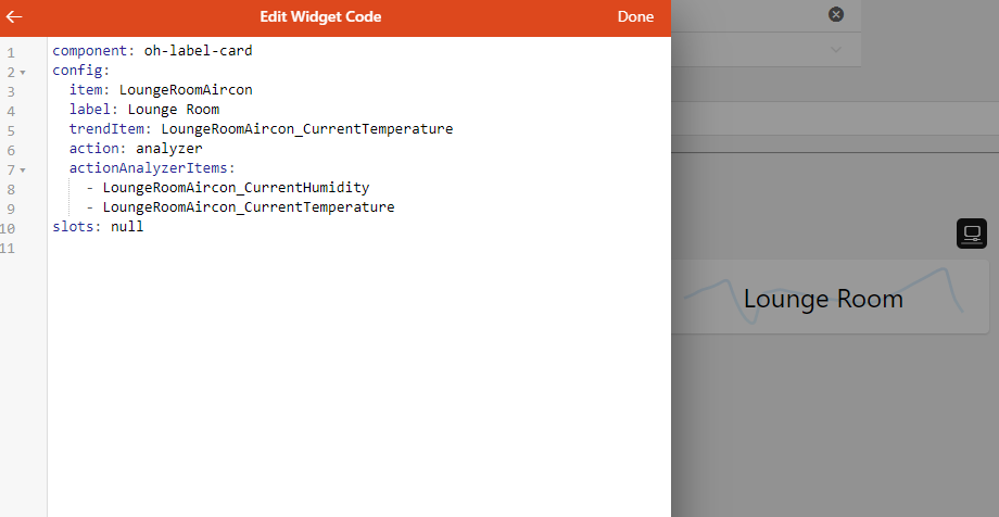

I found it easier to put a widget on a page and set it up using configure widget then edit widget code gives you the YAML
Just to be clear here - you sure can use the YAML of the standard widgets and put them inside your custom widgets.
The difference here is, that you’re limited to the given config parameters of that widget then and elements might not fit together as well as if you’re doing it with the smaller underlying vue-components.
If you’re happy with the given possibilites of a standard widget, theres no real downside doing it that way.
I guess I just figured out how to do it that way first.
The label card from the last pic helped me figure out the structure in my Aircon widget

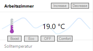

He everybody,
ok, I give up :frowning:
I’ve tried two different approaches:
Option 1:
Try to recreate the oh-label-card.vue from the repository using YAML.
It somehow works, but adding actions when clicking on the item is not possible since the action configuration property is only available for the oh-* widgets. So with the standard f7 components it’s not working.
Option 2:
Try to wrap a F7 card around the oh-label-card:
Partly works, but the oh-label-card comes always with a padding / margin that i cannot change (i’ve just marked it in yellow for a better view). The button beyond does not have a border.
To eliminate this, I would need to change the margin via the config section in the YAML, but in order for this to work, there must be a corresponding config tag in the vue code or the oh-label-card. But there isn’t one

    - component: oh-label-card
        trendItem: ThermostatArbeitszimmerErdgeschoss_temperature
        action: analyzer
        actionAnalyzerItems:
          - ThermostatArbeitszimmerErdgeschoss_Solltemperatur
          - ThermostatArbeitszimmerErdgeschoss_temperature
        item: ThermostatArbeitszimmerErdgeschoss_Solltemperatur
        title: Arbeitszimmer
        icon: oh:temperature
        actionAnalyzerCoordSystem: time
        vertical: false
    - component: oh-button
        text: my button
So in the end:
  • I’m not able to create my customer thermostat widgest based on the oh-label-card
  • I’ve learned a lot about how the widgets work and also quite a lot about vue and f7
Thanks a lot for your help so far and your discussions.

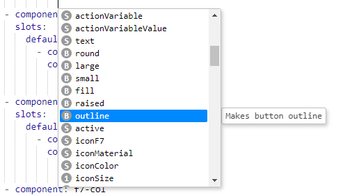

The standard oh-button does not come with a background or outline - but you could add both with a config parameter.
All available paramters shows up as a tooltip while you’re writing your code, if not you can trigger it with ‘CTRL + Space’

        vertical: false
    - component: f7-row
        class:
          - padding
        default:
          - component: f7-col
              default:
                    text: my button 1
                    fill: true
          - component: f7-col
              default:
                    text: my button 2
                    fill: true
          - component: f7-col
              default:
                    text: my button 3
                    outline: true
          - component: f7-col
              default:
                    text: my button 4
                    outline: true
I have read many of your tutorials so I know this is not true. I am in the same boat the majority of that widget is not my work.
So I Created the items for this using create equipment from thing in the mode page and saw that the item names had a prefix.
Items
BedroomAircon_MasterSwitch
BedroomAircon_mode
BedroomAircon_targetTemperature
Its the Sesibo binding so all the item names follow the same pattern. The “group” equipment name is BedroomAircon
So when you follow the default props the item value is this BedroomAircon
Looking at only the power button / _MasterSwitch it builds the actionItem
    action: toggle
    actionItem: =(props.item + "_MasterSwitch")
    actionCommand: ON
    actionCommandAlt: OFF
    icon-f7: power
    iconSize: 28
    iconColor: '=(items[props.item + "_MasterSwitch"].state === "OFF") ? "red" : "green"'
Only one parameter when adding the custom widget on the page. You can select add from model then you don’t need to set the item. I leaving it in to allow the user multiple way to add a widget to pages.
I only have 2 parameters now instead of 8

1: How can I make a multiple item selection in the config? I tried searching, but couldn’t find anything
2: what is the syntax if I want to add items from the config to the actionAnalyzerItems list?
I know that for a single setting it is e.g. item: =props.ItemName
But for a YAML list, i’m stuck
   - //<what needs to be here if the item from the config can be adressed via props.ItemName
I’ve been planning to rewrite the cards as I did with the cells, that is, make an oh-card component that you can customize with slots (header, footer, beforeContent, afterContent) and make oh-label-card and friends based on oh-card instead of f7-card directly. When that’s done you will be able to add content to every card by putting components in slots.
actionAnalyzerItems: =[props.item]
