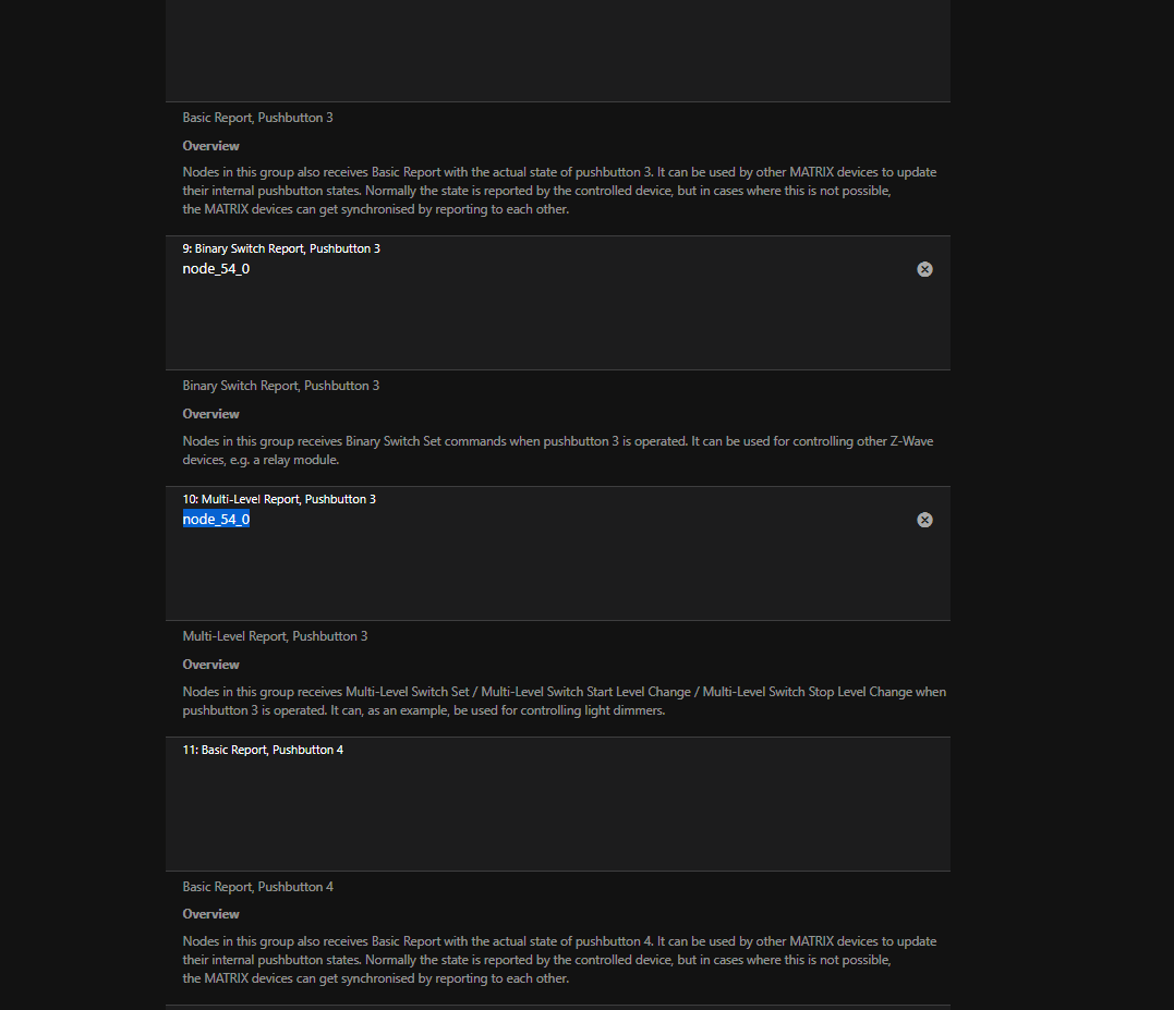

When trying to use this method i get this strange UI behavior that i have to write my associations ?
Compared to before. Where i only have to select the thing and select the endpoint.
I don’t use associations but i checked it with my devices and i can choose other nodes.
Either it is a bug in the binding or something is wrong with the database concerning your devices. Have a look at opensmarthouse.org
