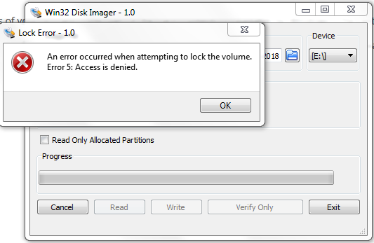

@Dim . I just been trying to backup entire SD using Win32 Disk Imager . However for some reason getting this error when hiting Read. Is this a common problem with SD`s
I think that Google will help you more than me… I used it and I found:
