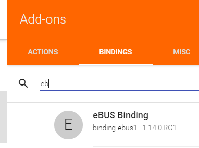

I don’t see the EBus Binding beeing available in openHAB2-addons, so this is something to be addressed to the binding author, not a critical issue within RC1.

It’s there for me. Try clearing browser cache.
The log extract shows an openHAB2 Binding version (BridgeHandler) which is not in the distro. You are refering to an openHAB1 Binding.
@wseifert needs to open a GitHub issue on the GitHub binding repo then.
