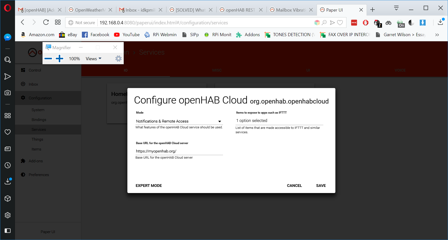

In the PaperUI if I look there I currently see the following.
The “one” item is this ‘cHolly_Phone,cZac_Phone,cOrian_Phone,cPaul_Phone,cSue_Phone,cSue_Tag,LocalWeather_Current_WindGust,Current_Pollen (cHolly_Phone,cZac_Phone,cOrian_Phone,cPaul_Phone,cSue_Phone,cSue_Tag,LocalWeather_Current_WindGust,Current_Pollen)’

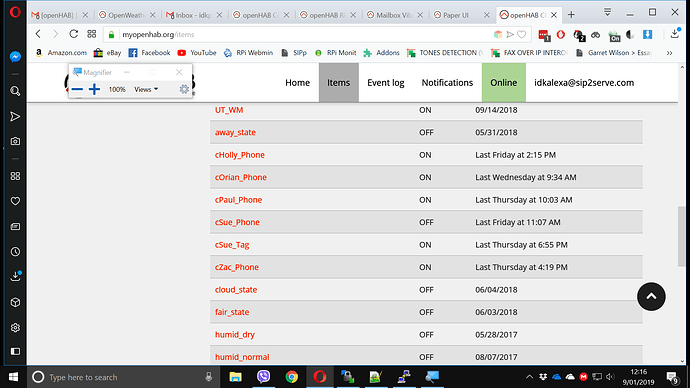

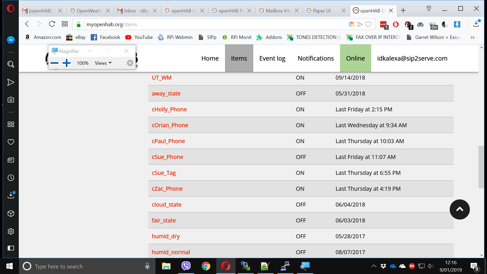

and if I look at the items list on myopenhab server it has a completely different list AND I note that it has seen no update for around a week, which is probably when I last played in this area..

  4. I logged into myopenhab.org and deleted all items and events
  5. added the items to be added using the config file
  6. exercised each item in turn through REST and checked they appeared in the myopenhab.org website list.

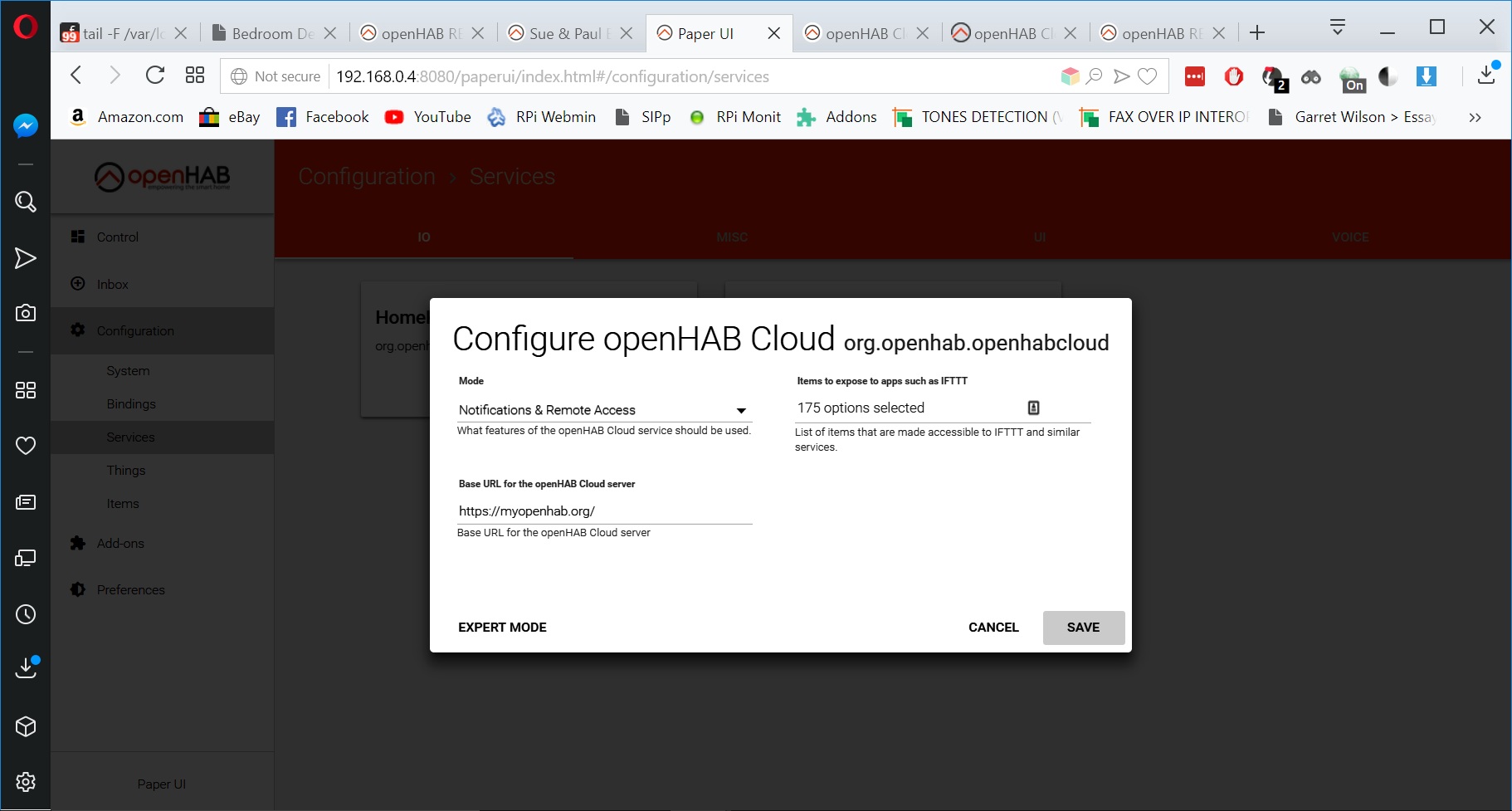

That seemed fine, I have avoided PaperUI list for a few reasons.
  1. The list selection mechanism is awful to work with, the list is too small as a drop down and is not sorted using the item name but instead it uses the quoted element text".
  2. There is no simply way to find which item(s) are already selected.
  3. Adding one item seems to overide what was previously selected, this along with the other two points above makes the selection method really poor for me.

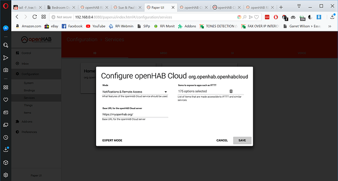

  4. I added around twenty items using the expose parameter in the cfg file and it is reporting a 175 items as being selected. Not sure why. I think this is a bug.
see screen shot
Thanks Rich for you help, I will hopefully make some progress now that my items are being exposed to the cloud correctly.

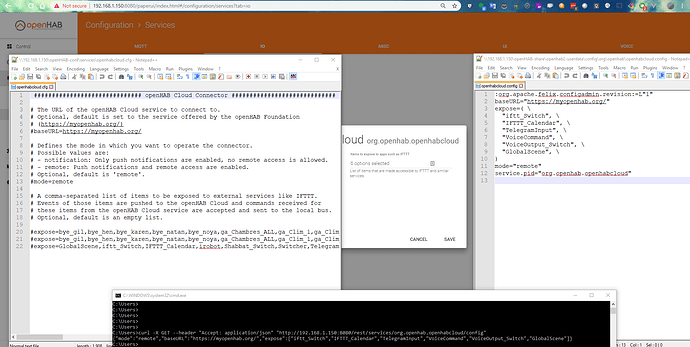

Hi, i am driving crazy
it worked in the past.
Yes, i know that the items should be updated to be displayed into myopenhab
i have updated all the items from CURL

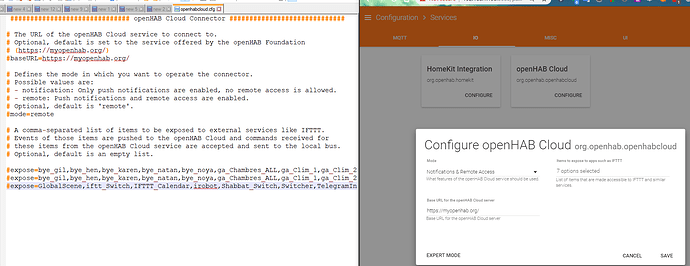

openhabcloud.cfg :
#mode=remote
expose=bye_gil,bye_hen,bye_karen,bye_natan,bye_noya,ga_Chambres_ALL,ga_Clim_1,ga_Clim_2,ga_Clim_3,ga_Clim_4,ga_Clim_5,ga_Clim_ALL,ga_irobot,ga_led_all,ga_led_desk,ga_led_mini2,ga_led_mini3,ga_led_mini4,ga_Light_ALL,ga_Salon_ALL,ga_Switcher,ga_Toilets,GlobalScene,iftt_Switch,IFTTT_Calendar,irobot,M1_1,M1_2,M1_3,M1_4,msg_gil,msg_hen,msg_karen,msg_nathan,msg_noya,msg_tahel,Shabbat_Switch,SP2_1,SP2_2,SP2_3,Switcher,TelegramInput,TerraseSwitch2,Toilets,VoiceCommand,VoiceToSpeak,VoiceToTV,wmd_gil,wmd_global,wmd_hen,wmd_karen,wmd_noya,ZWaveSwitch1_Channel1_Right,ZWaveSwitch1_Channel2_Left
i have followed the two posts without success

First some details.

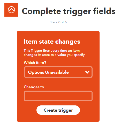

When you updated the Item, did you change their sate? That IFTTT trigger requires the Item to change state.
Please please please don’t expose ALL your Items to IFTTT. Only expose that Items that you are actually using through IFTTT. Whenever myopenhab.org gets slow or goes offline, it’s because of users exposing all their Items even when they only need to expose a couple.
You have a mix of configuration through PaperUI and cfg files. Typically the cfg file will take precedence. But it might have a problem with the mode being commented out. Try removing the comment for the mode line.

the number 581 is a defect. it do not reflect the accurate number set in the file (20)

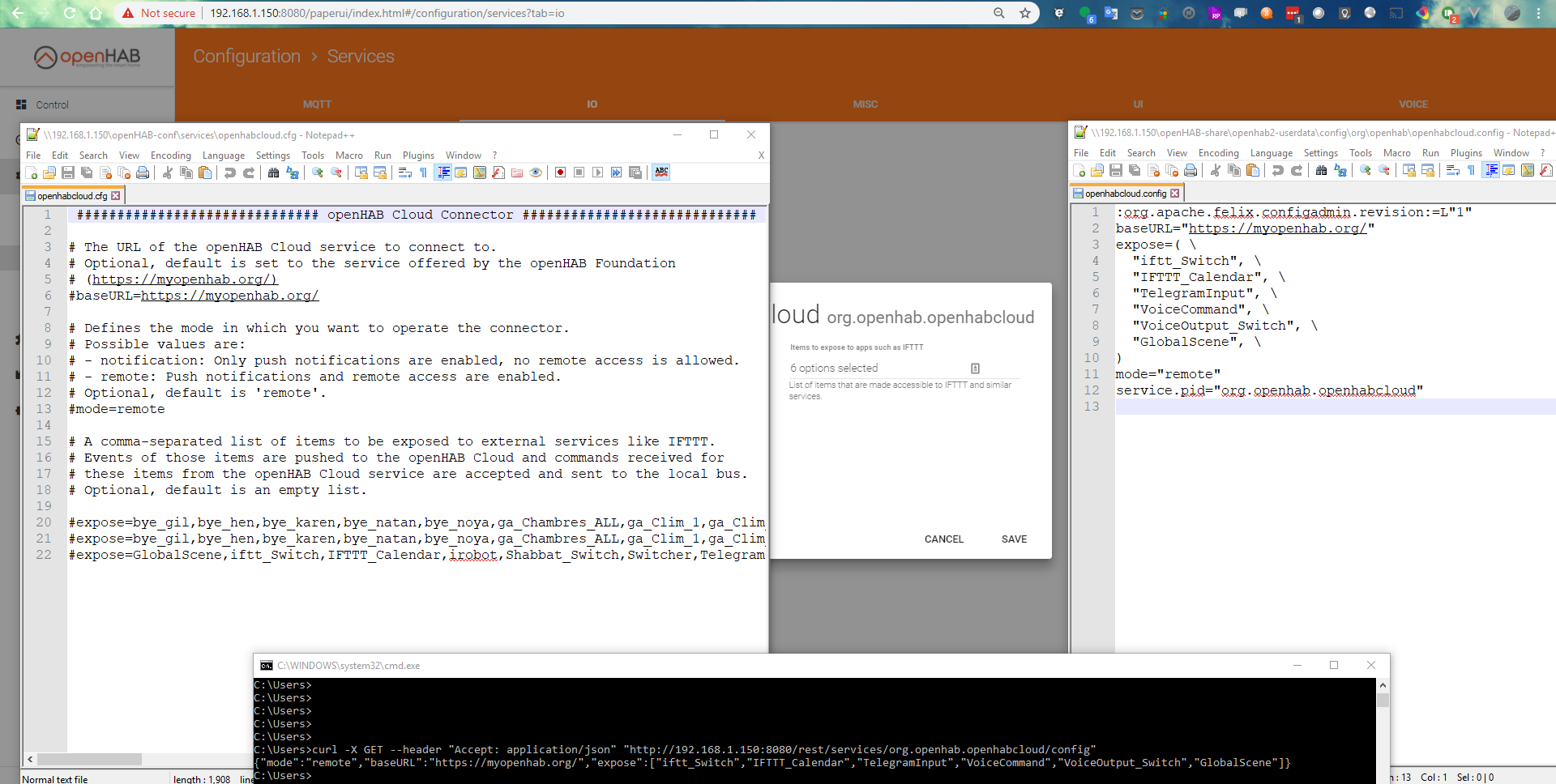

  • I have commented all the file
  • unselect paper ui
  • delete all the Items configured to be shared in PaperUI (i.e. make them no longer listed in the cloud connector config, don’t delete the actual Items).
  • Stop Server
  • Find and delete /var/lib/openhab2/org/openhab/openhabcloud.conf
  • Delete cache and temp
  • Start server

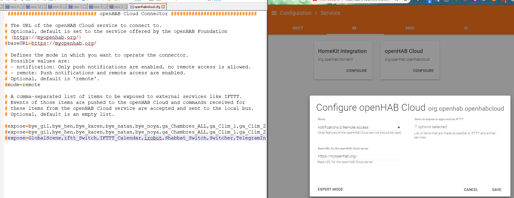

  • Select to expose 7 items in the paperui
  • from a sitemap, Update from OFF to ON and ON to OFF, the exposed items
    Switch item=GlobalScene mappings=[ON=“All On”,OFF=“All Off”]
    Switch item=iftt_Switch mappings=[ON=“All On”,OFF=“All Off”]
    Switch item=IFTTT_Calendar mappings=[ON=“All On”,OFF=“All Off”]
    Switch item=Shabbat_Switch mappings=[ON=“All On”,OFF=“All Off”]
    Switch item=TelegramInput mappings=[ON=“All On”,OFF=“All Off”]
    Switch item=VoiceCommand mappings=[ON=“All On”,OFF=“All Off”]
    Switch item=VoiceToSpeak mappings=[ON=“All On”,OFF=“All Off”]
    Switch item=irobot mappings=[ON=“All On”,OFF=“All Off”]
Some items are defined as string items but displayed as a switch to change easily the state.
  • Wait 30 minutes
Still do not work :frowning:

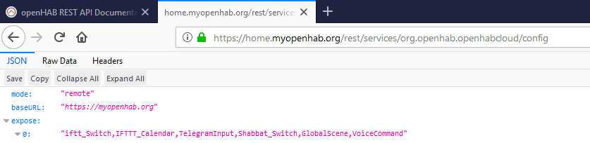

@rlkoshak, it do not work yet
in spite that the expose is well stored
What i am missing?
i have also uninstalled and reinstalled the openhabcloud Binding without sucsess
I don’t know. The steps you took are the ones I would recommend.
It is encouraging that the list matches between PaperUI and the cfg file. But the error does show there is some sort of communication problem between OH and myopenhab.org.
All I can say is that others are doing this successfully. I can’t say what is going wrong for your setup.
