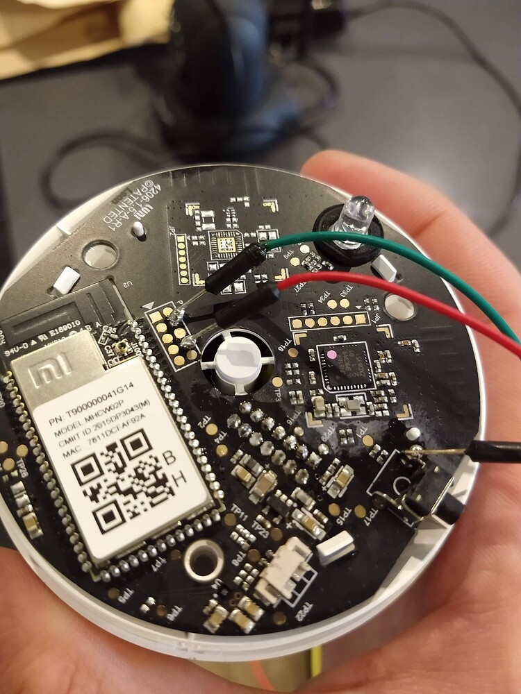

solved!
if you mix rx and tx, this can happen. change rx and tx connections
After few restarts directly from power my Gateway not boot I receive this error:

I have a big Problem cause my Gateway looks inside very different…
Someone can help by finding RX & TX ?
Thanx so much

I’ve the same issue with the Model ZNDMWG03LM.
I’ve tried to open the port but saw only hieroglyphs in Putty.
I think I’ve connected Rx and Tx wrong.
Maybe somebody here can tell me where I’ve to connect Rx and Tx on the board?
Here is the picture from Xiaomi Mijia Gateway 3 board …
@coupeaze
Yes, that would be very interesting!
How did you open the case of the gateway? Do you have some photos or a short video for this?
And I agree, somebody knows where to connect and what to send via putty?
Thanks.

Can anybody answer the technical questions, how to connect and open port 9898 for this gateway?
@coupeaze Do you think these are the correct pins but the wrong order?
Stay healthy!
try to change rx and tx connections
@coupeaze Could you test that please and confirm if this works?

bottom view from new GW board
top view from the new Gateway 3 board
Does somebody know where to connect what to get the port 9898 openend?

yes, sure. I made typical connection, like on pic, connected correctly via putty, got correct answer from hab, got value of open_pf, it equals 3.

Pic is from internet, that was not my picturе, but connection the same. Data from my device:
