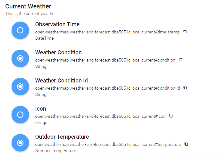

I’m using the latest binding version 2.5.5 but can’t find the Icon-Id Channel within PaperUI (not even with the ‘Show more’ button like for the condition-id channel
so I wrote my own item file but the string value for both condition-id and icon-id are the same

after a OH restart I can’t see my manually defined Item anymore in PaperUI under Control
I can confirm the Item is still there under Configuration Items
my Items file is as follows (this is the only manually configured item for my weathermap binding - all the others are configured within PaperUI)
String Weather_Icon_ID "Weather Icon ID [%s]" <sun_clouds> { channel="openweathermap:weather-and-forecast:dbe5051c:local:current#icon-id" }
before the OH restart under Control I saw the Item sharing the same value with condition-id (for example: 800)
the only reason I configured it within an items file is the missing channel for icon-id
Thanks for the example @greyslater. Now the problem is clear to me. This is a typical bug, well-known bug which occurres during update. The new structure for an enhanced Thing is not automatically applied to existing Things. You have to remove and recreate the Thing to see the added Channels. Please give it a try.
