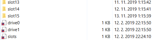

What I have on external drive is:
Directory amanda-backup
amanda3
Directory with slots
and data in slots

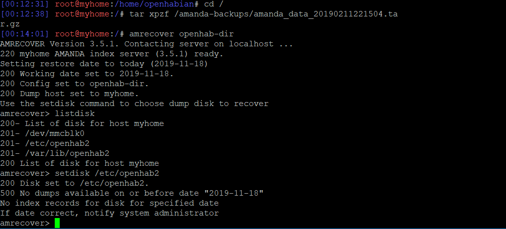

Now, I know how to restore files. Issue is, that it cannot see my backup.
When I set date to backup date, it always show me “500 No dumps on or before date…”
So it looks like database wasn’t restored.
I moved it into amand-backups directory and run “tar xpzf /amanda-backups/amanda_data_20190211221504.tar.gz”
It went without any errors.
Any idea?
Come on I already wrote it:
cd / before tar xpf
and if it doesn’t work go for B)

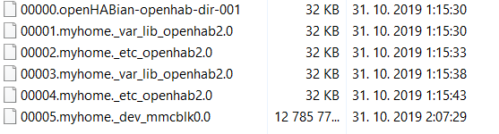

And option B doesn’t work wor me. All files except 00005.myhome._dev_mmcblk0.0 are basicaly empty. They have 32KB. Only this one have around 12GB. But I don’t know how to open it. I tried last page from tutorial, but without success. It’s not tar file.
Well then unfortunately there was nothing backed up on those dates (which also explains the “no dump” output). Use amoverview <config> to get a hint what’s there.
You could try setdisk /dev/mmcblk0 in amrecover for that only file to contain anything.
Not 100% sure but it should be a gzip’ed raw copy of the partition. You can use dd to write it to an external SD writer (/dev/sda or whatever that shows up as). You can mount it like an ISO, too, see https://major.io/p/mounting-a-raw-partition-file-made-with-dd-or-dd_rescue-in-linux/
[00:36:37] root@openhabianpi:/volatile/backup/slots# dd if=slot9/00005.openhabianpi._dev_mmcblk0.0 bs=32k skip=1 of=/volatile/temp/restoretest
[00:44:07] root@openhabianpi:/volatile/backup/slots# file /volatile/temp/restoretest
/volatile/temp/restoretest: gzip compressed data, last modified: Thu Sep 26 23:13:37 2019, max speed, from Unix, original size 3046637568
[00:44:26] root@openhabianpi:/volatile/backup/slots# gunzip -c /volatile/temp/restoretest>/volatile/temp/restoretest2
[00:44:26] root@openhabianpi:/volatile/backup/slots# #untested: dd if=/volatile/temp/restoretest2 of=/dev/sda bs=1M
Thanks a lot, man!
I was able to mount that file as image.

I had backups from each day. There are slots and modification dates fits. Weird is, that data in all slots are same. It’s few months old backup. It looks like same date as last manual backup of openhab. But anyway, it helped me a lot. I have to go again through readme and wind what I screwed.
