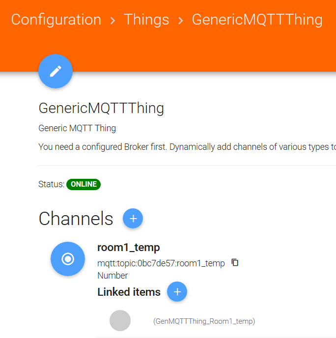

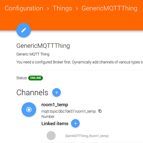

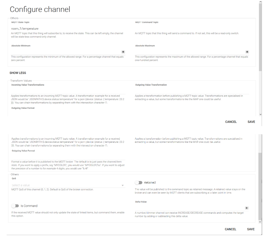

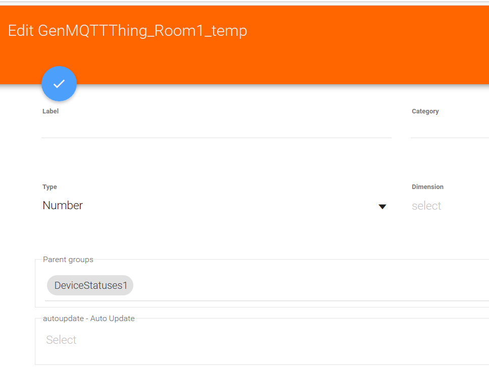

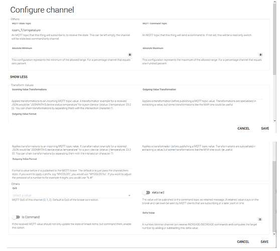

Show me your thing and number channel, please
@vzorglub:
Thank you for your helpfulness and patience.
Please show me the channel screen, please
Now, I hope that I have understand what do you mean, sorry.
And when you configure this (assuming that the topic is correct) it doesn’t work?
But the same topic works as a Text channel?
It should work
Please show the logs when the value is updated via MQTT. For the Number channel set up please
The datas wich I riceive were displayed correctly on my basic ui.
