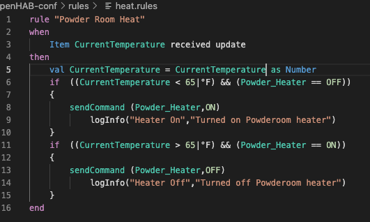

Here is where I am and think am close.Thoughts?
Please post code in code fences, rather than screenshots. It’s easier to highlight extracts and offer suggestions for everyone.
    Item CurrentTemperature received update
Okay, that’s an Item.

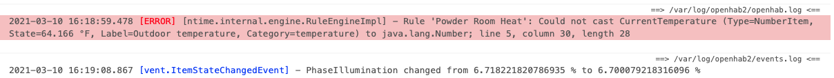

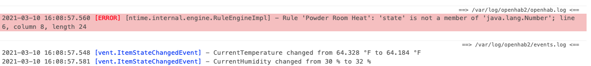

   val CurrentTemperature = CurrentTemperature as Number
First, don’t make new variables with the same name as your Items. It confuses me, and probably confuses the rules parser too.
Second, you can’t get an Item as a Number variable. An Item is a complex object, with many properties like name, label, type, etc. It’s usually the state property you’d be interested in.
But you don’t even need state as a Number. You just want to compare, so compare it with another Quantity with units.
So let’s have a try -
    if ( (CurrentTemperature.state < 65|°F) && (Powder_Heater.state == OFF) ) {
...etc
Note that Powder_Heater is another Item, where you’d want to be looking at the state.
