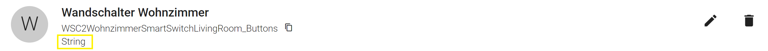

In the first step I’ve created the following item:
But I’m not sure which type I should use: Switch, Contact, Text,
I’ve tried different types but I’m not able to link the channel to this item.
The item selection is always empty.

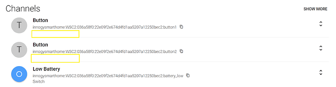

The Item type required for each Channel is identified next to the Channel in PaperUI.
In the above screen shot, Heartbeat and Smoke must be linked to a Switch Item. Battery Level must be linked to a Number Item.
Possibly.
Linking two Channels to one Item is a rare occurrence. This thread is the first one I’ve encountered where anyone has attempted it.
Typically one has one Channel linked to on Item. If a command sent or received on one Item needs to trigger some other device to do something, that is done through Rules.

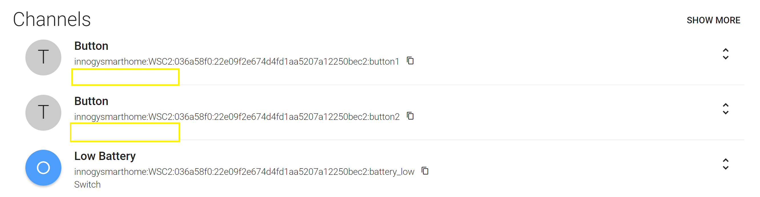

Okay this might be the problem here. PaperUI does not show any Type next to the Channel.
And that’s correct based on the REST API these channels do not have a Type.
But the Thing has two more Channels button1_count and button2_count, which are not shown by PaperUI. If they were shown, then it should be possible to create an Item link to the channels.

The “Button” channels are trigger channels that by design cannot be bound to an item, but used in rules:
rule "Button fired..."
    Channel 'innogysmarthome:WSC2:mybridge:myPushButton:button1' triggered PRESSED
I should add this to the binding docs as an example…
But the Button Channels button1_count and button2_count should be available right?
Yes, they are marked as advanced and thus hidden behind the „show more“ button in the PaperUI channels list.
