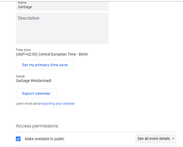

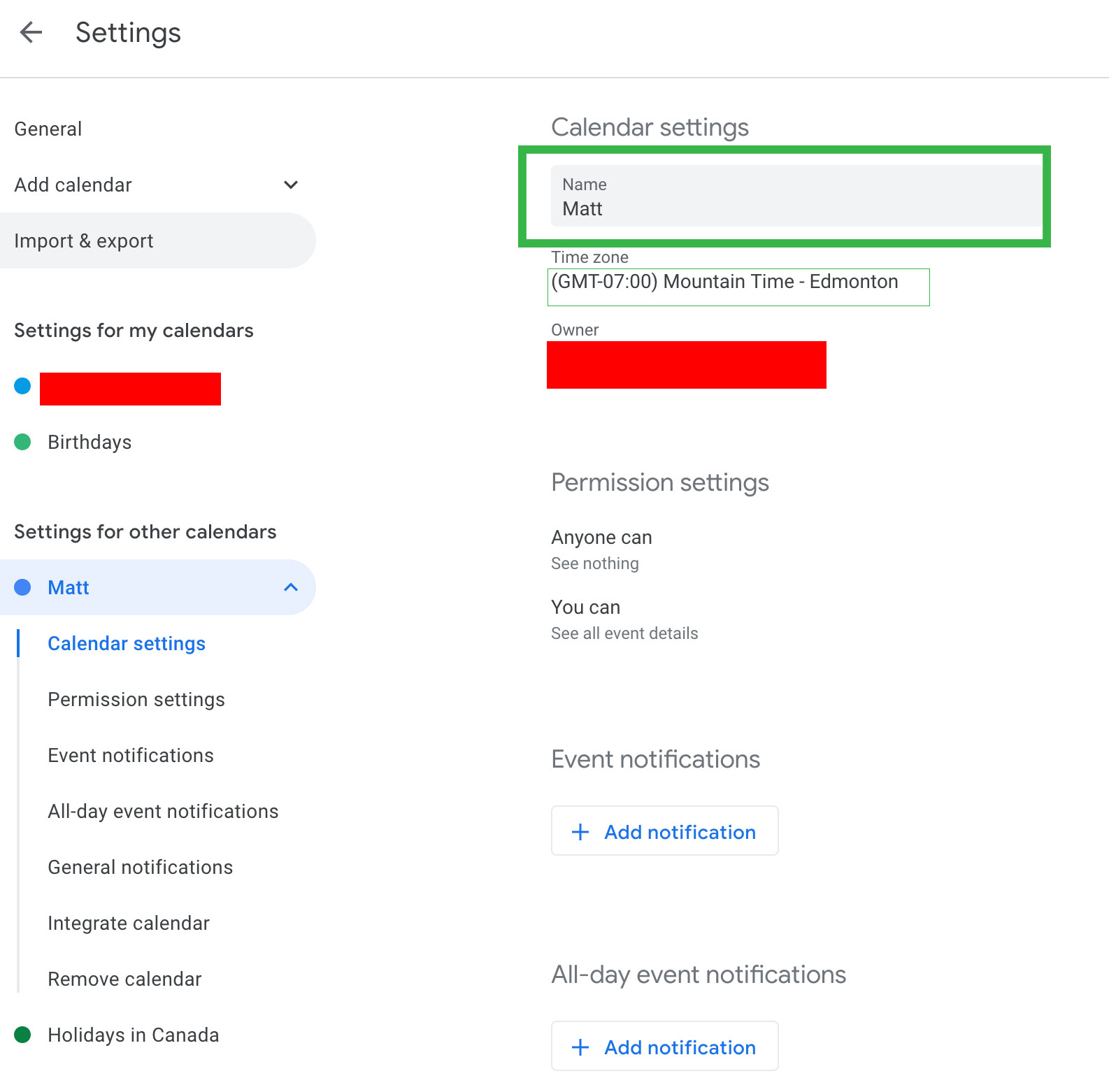

  7. Get the name of the calendar you want to use from google from the calendar settings page:

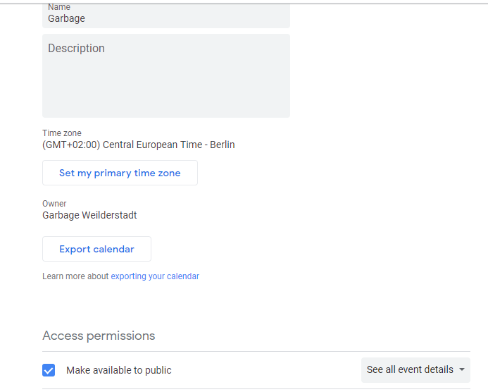

Guys,
I am getting crazy with google account settings.
I have created new calendar in google. Named it Garbage and made it available to all
Tried several links to access the calendar.
The latest caldavio.cfg looks like that:
caldavio:Garbage:url=https://calendar.google.com/calendar/dav/<my_new_google_account>/events
caldavio:Garbage:username=<my_google_login_without_@gmail.com>
caldavio:Garbage:password=<my_google_account_password>
caldavio:Garbage:reloadInterval=2
caldavio:Garbage:preloadTime=18720
caldavio:Garbage:disableCertificateVerification=true
caldavio:Garbage:charset=UTF-8
caldavio:Garbage:lastModifiedFileTimeStampValid=false
and placing the link in the browser, giving creditals seems to be worlking
My DEBUG and TRACE is telling me there is no calendas named “Garbage” but there is..

Hey, yeah I did share it. It’s all above.
Dis you enable less secure apps?
Yeah I pasted your css in a blank template but it’s not yet quite the same so wondered if you have other CSS settings?
Ahh, yeah I kinda did somewhat dirty css that was for my specific use case. You should be able to tweak it if you have a larger display. You can also add more entries and tweak the css if you need too.
