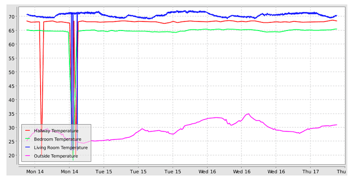

I’m running openhabian with OH 2.4 and I have 3 aeotec multisensor 6 that report temperature. What I’ve noticed is that the sensors report a Celsius temperature once a day causing a spike in my chart. The odd thing is that it apears to happen at the exact same time every day for each sensor. The sensors are all set to report fahrenheit. My OH global setting is for imperial units. You can see what happens in the image. The outside temperature is reported by the WU binding. Any ideas would be greatly appreciated.
. As a workaround, I though I might just set them all to celsius and use a JS transformation to Fahrenheit, but if there is a real fix, I’d like to try that first.Yes and then stick to celsius like the rest of the world… Just kidding

Have you converted to use UoM for your Temperature items. For example
Number:Temperature TempItem "Temp [%.1f %unit%]"
If not, the MS6 will give you whatever units it feels like at the time it sends the temp update. At least that was my experience with the MS6.

The binding defines this type for the temperature now, Number:Temperature. I don’t believe this was the case before. I’m pretty sure it was just Number. The docs say this type will convert the value returned from the binding to the UoM as set under System. I changed my sensors temperature items to this type and have not had a spike yet, but I’ll give it a day or so to see what happens. It also seems that the UoM of the sensor is not set in the binding anymore, just threshold values are set. @mhilbush @ssalonen @vzorglub
So, no more spikes since Monday evening after I changed the item type. I’m going to consider this resolved now.
