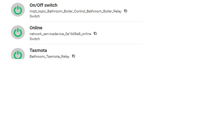

Untitled
Now I’m afraid I’ve to many items. (ignore the online thing, that’s just to see if my phone is in the wifi or not)
To answer your question:
I thought: 1 device to define the switch on my basic UI and 1 devide to define the relay I want to control. But I may be wrong
