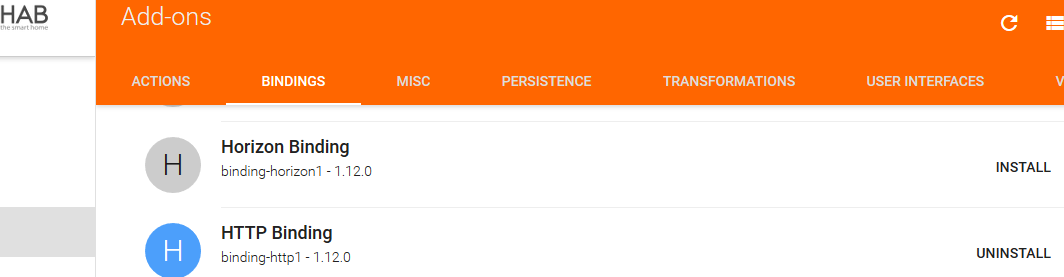

@H102
The 404 error comes from telegram responding that the binding asked for an address it couldn’t find.
Nothing to do with the http binding
