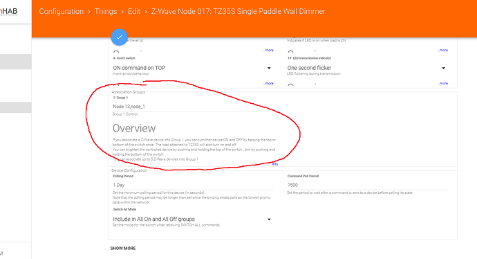

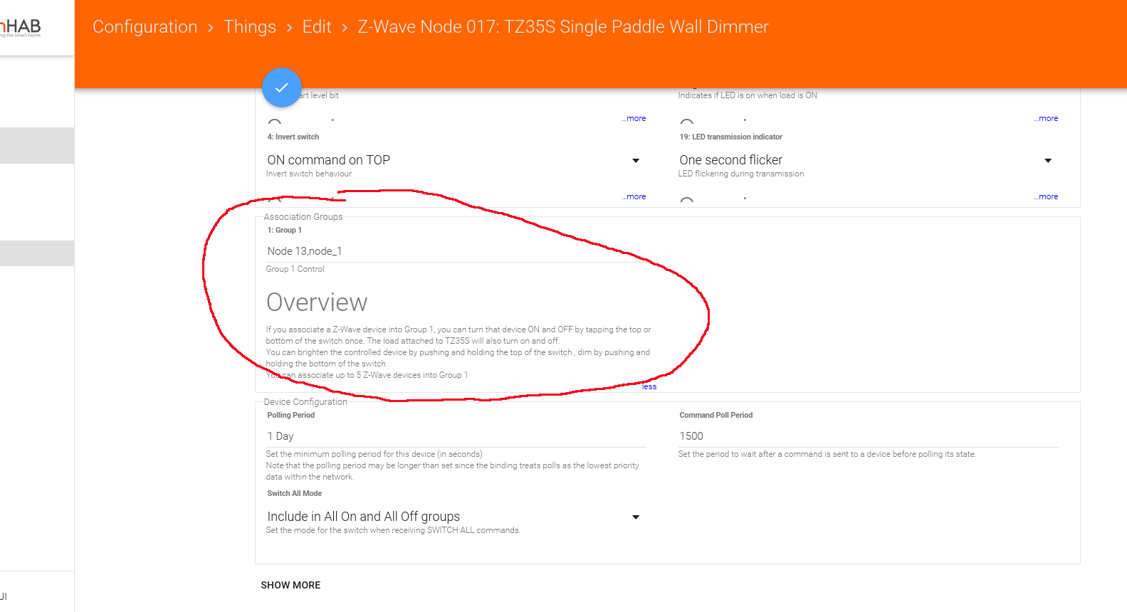

Hi @chris, afer upgrading openhab all my switches (TKB home TZ65D) appear in the INBOX with wrong type - as TZ35S.
I have three kinds of TKB Home devices - TZ65D,TZ65S,TZ66D. Before updating openhab their type was correctly determined by openhab. But now all of this devices was appeared as TZ35S in inbox.
What is the difference between these devices?
Main difference is count of association groups:
TZ65S (as TZ35S) has group 1
whereas TZ65D has 3 association groups
I think my trouble related to TZ35S reporting as TZ65D
I also have a device ID 0808:0808

The problem is that I can’t use the second dimmer button. Two groups can be assigned to it (group 2 - one click, group 3 - double click).
Almost all my dimmers do not have a directly connected load.
I use z-wave dimmable lamps (Domitech Smart LED ) and control it through association groups
I expect to see the setting of the other association groups (group 2, group 3, group 4 ).

In the current state of the database, having the latest version of OpenHub, how can I configure the associative group 2, 3 or 4?
If these groups are not in the database, then it is not possible to do this via OH unfortunately.
@chris if you add this device as TZ35D
then users of TZ35S can configure group 1
and users of TZ35D can set up groups 1-4
and we will all see 4 groups in the settings, which is a bit incorrect for the one-button version users
Tell me if I’m wrong.
