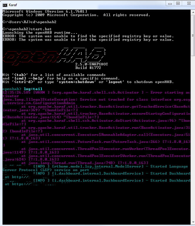

I just started to install this program and when I execute the start.bat file i get an error…
ERROR: The system was unable to find the specified registry key or value
Platform information:
Hardware: i7
OS: Win7
Java Runtime Environment: Zulu 8.28.0.1 04ade267f927
openHAB version: 2.5.0 build 1772

umm, the system variable name in your screenshot is JAVE_HOME.
You want JAVA _HOME

OMG I FEEL LIKE AN IDIOT ! (caps deserving in this one). Thank you for all that responded, I now hang my head in shame

Credit for posting your own screenshot, and not pointing at what you thought you had done
