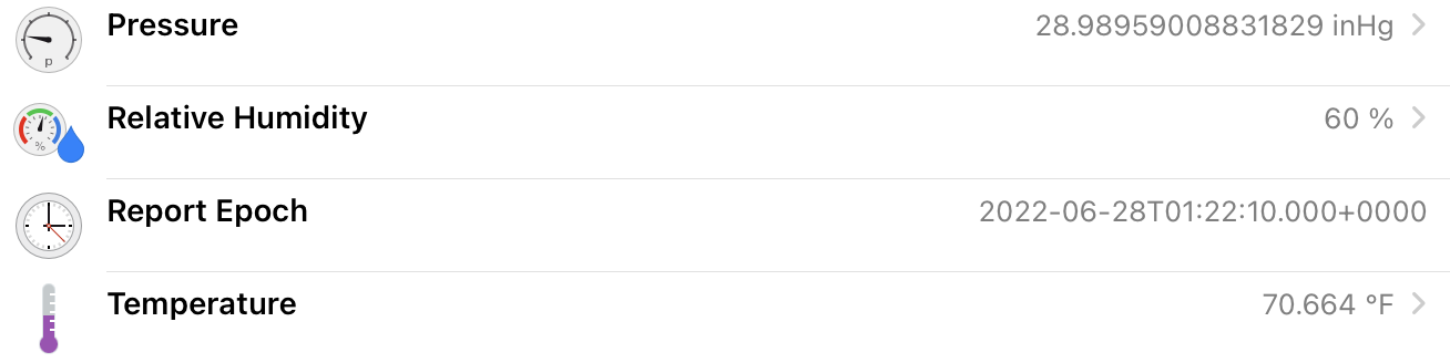

Question: The “temperature” item is reporting in Celcius. In the Tempest setup app, it’s set to Farenheit, but that seems to be ignored. Any way to get the temp item in F, or do I need to create a new item/rule for that?
The weather flow system operates natively using SI measurements, so the setting in the tempest app is used just for displaying the data in that app. The binding is “Units of Measurement” aware, so you may just need to change your openhab configuration to use the right system of units:
Settings → Regional Settings → Click the “Show Advanced” button → Measurement System
Note that if you’re in the US, we use the “U.S. Customary” measurements system, which differs from the U.K. “Imperial” system in a few places (their units for pints and gallons, for example are quite a bit different than those in the US). I haven’t investigated to see what conversions are actually being used. I don’t think though, that the differences matter for anything you might get from the weather sensors. For example:

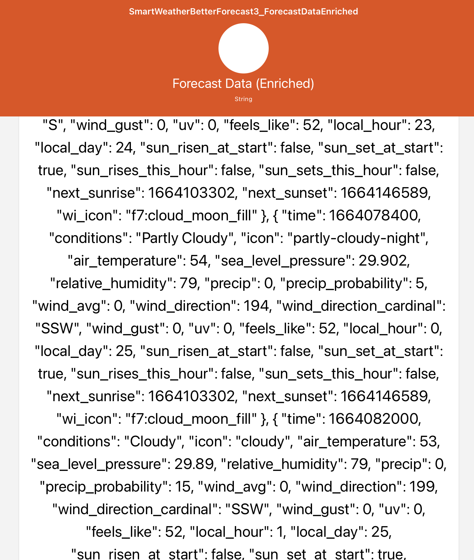

For the first problem with your weather card widget, I would make sure that you’re using the enriched weather channel, as this has some things that make the weather card widget much simpler. Second, I’d verify that you’re using the weather card yaml from this project. There’s an “originaI” widget available elsewhere that looks similar but doesn’t work with this data. I’d then verify that the data in the forecast item looks valid (though you said it does have data).

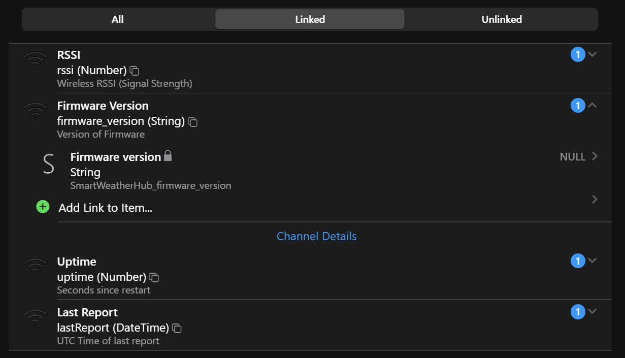

No errors in openhab.log
Items are linked to channels, but show no values.
I have had my HUB exchanged some time ago, this one is quite new and different (e.g. has USB-C port), not sure if it may be related. Firmware is 177. I see all information on web, but I understand the binding should read local information. As mentioned, station (Tempest) sends all data well, including rapid events, which is sufficient. As it seems to me it updates the Item immediately to tiggering change on wind_gust seems to work. I haven’t yet tried triggering precipitation_type or strike_count but guess they would work as well.
[quote] I would make sure that you’re using the enriched weather channel [/quote]
Yes

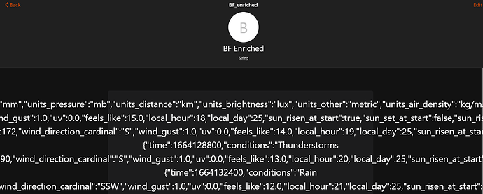

I do. In fact, I tried to try both, but only yours has the forecast item, the other works on item_prefix basis.
My enriched item looks like

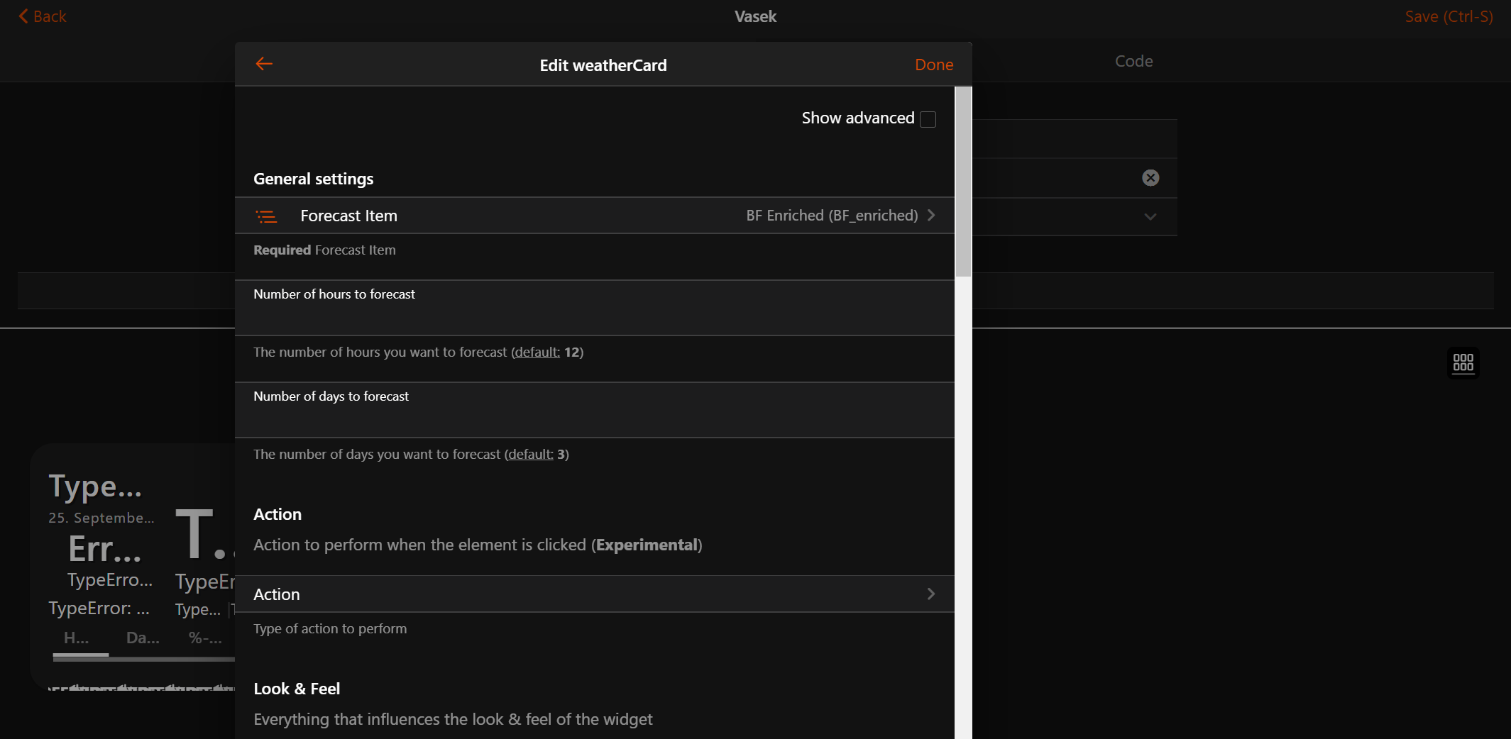

Done. You can see how the widget looks on this picture
The error message is "TypeError: Cannot read properties of undefined (reading ‘current conditions’)

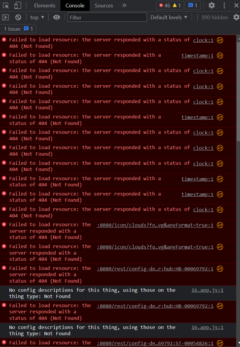

This may be it - quite a lot of errors came out.
I’ll try some googling, digging or experimenting and keep you posted.
Hi-
Since you’ve replaced your hub, I assume you’ve updated the new serial number of the hub in the various places (things definitions, items and such). Weatherflow hasn’t published the 177 API but it’s hard to imagine they’ve changed something that would cause problems. If your hub thing is online and you’re receiving updates, it’s probably okay not to worry about the hub channels… there’s nothing really important there.
Your configuration and item value looks okay, but you’re getting more errors than I’d expect… and 404 (not found) at that. On my install of 3.3.0-SNAPSHOT, I don’t get any 404 errors. You might want to look at the “network” tab and do a reload of the page. That might give you some clues, and I’ll see if I can find a machine which chrome or edge to test on.

The widget yaml file is probably very sensitive to re-formatting, like extra spaces or line breaks. So, if you’re getting javascript errors in your browser console, that could be a possible source of problems.
Bill
Thanks a lot - you brought my attention to it after I gave up and surprisingly I guess I was able to fix it :-).
I found out in other browser that the error points to missing dummy.js - which was not present in your distribution.
I than I changed line 198 of the yaml from dummy.js to rapidWind.js - done a few refresh and voila!
