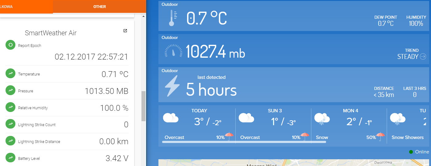

Hi! I’m getting this warn:
[WARN ] [nternal.SmartWeatherDiscoveryService] - DiscoveryServiceCallback not set. This shouldn’t happen!
Unfortunately items stopped refreshing. Looking for the reason.

Hi! I’m on 2.2. I did all “soft” solutions I could do. The values sometimes freezes. I see that epoch refreshes and temperature seems to be ok, however pressure is wrong. Also some trivial finsing is that pressure should be in “mb” instead of “MB”. Could you look into the pressure “issue”?

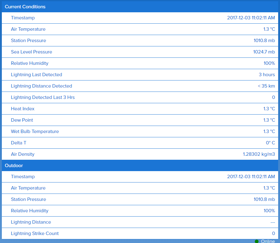

I see that pressure is being updated! However on WeatherFlow status page you can see “sea level pressure” and your binding provides “station pressure”. Does WF station send calculated sea level pressure and other calculated parameters via UDP?
I will post an updated binding; note that the only change at the moment is related to formatting of data in PaperUI… MB->mbar and number of decimals.
I am pretty sure that the weatherflow app generates a number of calculations based on data you specify during setup. The sensors (and hub) only report the raw sensor data, which is what’s being provided by the binding.
