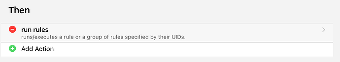

ah oke, will try to search, for now i have made the action, trigger a rule, there i can point a textual rule..
