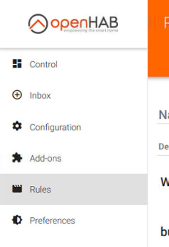

  1. In PaperUI select “Add-ons” and the “MISC” tab.
  2. Install “Rule Engine (Experimental)”
Once installed you should see a new Rules option on the left panel in PaperUI.
NOTE: Yes I know the image is fuzzy, I’ll take new screenshots before creating the PR to the Docs.
