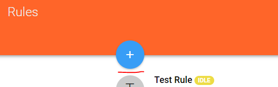

In PaperUI, select Rules from the left.
Press the big + to create a new Rule.

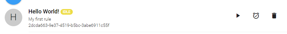

Delete or Disable the Rule
Now that we have tested the Rule you can delete the Rule by clicking on the trashcan icon. You can disable the Rule by clicking the clock icon.
Deleting the Rule removes it from the list. If you accidentally delete a Rule you can restore it from the backup JSONDB file in $OH_USERDATA/jsondb/backups.
Note that disabling a Rule will disable it in all the way’s it is called. So if you have another Rule that isn’t disabled that calls the disabled Rule, the disabled Rule will not execute.
Rule Satus
Notice the yellow “IDLE” next to the Rule name. This shows the current state of the Rule. Monitoring this status will show you what Rules are actively running, disabled, initializing, have a problem, etc.
