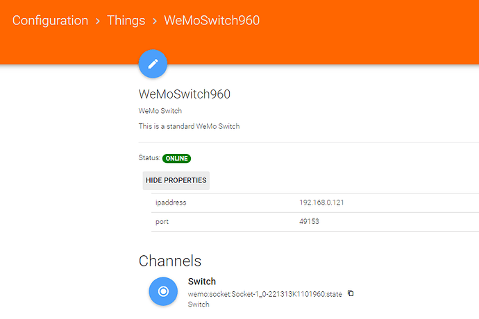

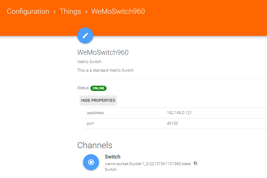

The device properties now include ip-address and port as shown below

I deleted the WeMo THINGS and re-found them but I do NOT have the HIDE PROPERTIES option so I can see the IP and Port. This may be a difference between OH 2.4 and OH 2.5?
My WeMo THINGS are all defined in the .thing file vs. using upnp.
It took a bit for OH to remove the binding → Active │ 80 │ 0.11.0.oh250M1 │ org.eclipse.smarthome.binding.wemo but it did after a bit even though it was removed from the services.cfg before I started OH up and the cache/tmp directories where cleaned up also.
All 19 of my WeMo devices are online right now. I’ll keep everyone posted . . .
