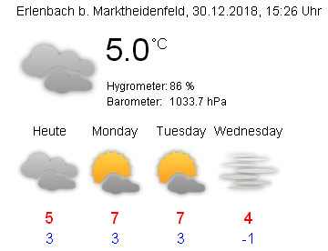

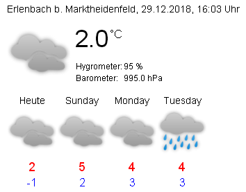

@Max_G
This is also possible in OH2! (I use ‘weather’ in OH2 on a Windows system!)
Your weather configuration goes to (if you are on Windows, if not, see at the bottom):
 \conf\services\weather.cfg
The weather.zip you have to devide up:
the folder “images” (and all subfolders) goes to:
\conf\html\weather-data\images
the folder “layouts” goes to:
\conf\html\weather-data\layouts
move the example.html from
to
\userdata\webapps\weather-data\layouts
Edit the example.html
first change all “paths” inside (after the word “static”):
 <link rel="stylesheet" type="text/css" href="static/weather-data/layouts/example.css" />
 <script type="text/javascript" src="static/weather-data/layouts/example.js"></script>
 <td rowspan="2"><img id="weather-icon" src="static/weather-data/images/${param:iconset}/${weather:condition.commonId}.png"/></td>
        <td><img src="static/weather-data/images/${param:iconset}/${forecast(0):condition.commonId}.png"/></td>
		<td><img src="static/weather-data/images/${param:iconset}/${forecast(1):condition.commonId}.png"/></td>
		<td><img src="static/weather-data/images/${param:iconset}/${forecast(2):condition.commonId}.png"/></td>
		<td><img src="static/weather-data/images/${param:iconset}/${forecast(3):condition.commonId}.png"/></td>
.sitemap: change “locationId” (if you are useing it) to your corresponding “locationId” from weather.cfg and “layout” =example (the name comes from example.html (without .html)
   Webview url="/weather?locationId=home&layout=example&iconset=colorful" height=15
The rest should be the same like in OH1.

Ok, I try to translate the windows paths to your linux paths:
/etc/openhab2/services/weather.cfg
/etc/openhab2/html/weather-data/images/
/etc/openhab2/html/weather-data/layouts/
/var/lib/openhab2/webapps/weather-data/layouts/example.html
EDIT the example.html and change the following:
If you had setup the weather.cfg (e.g. with Yahoo) then it should run until tomorrow! Then you have to change the provider in weather.cfg, e.g. DarkSky = ForecastIo !
