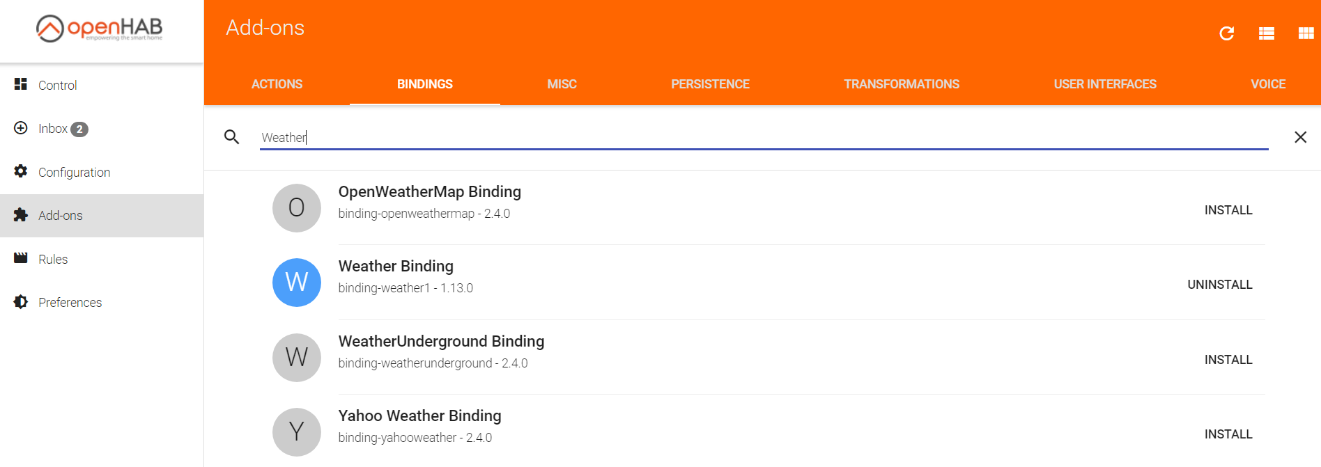

@Celaeno1 Thanks you but when I executed the feature:list | grep started, I didn’t find anything by the name of weather and after that when I am trying to to use feature:install openhab-binding-weather then I am getting the following error
Error executing command: No matching features for openhab-binding-weather/0
However, from the paperUI i can see that Binding is installed. Here’s the screenshot
What could be wrong?
