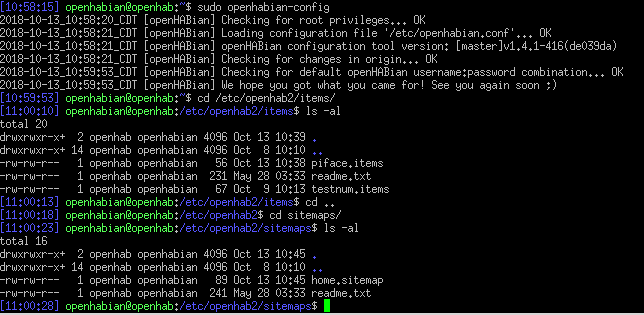

Use> ls -al to show ownership and permissions. I’m testing Piface on the latest snapshot as we chat here’s a pic.
Notice the piface is root root. I can use chown to change this or use the openhabian tools by typing> sudo openhabian-config
Then select “Apply Improvements” and “Fix Permissions”
Here is a pic of the same files after using openhabian tools.
Notice the owner and group has been changed to openhab opanhabian.

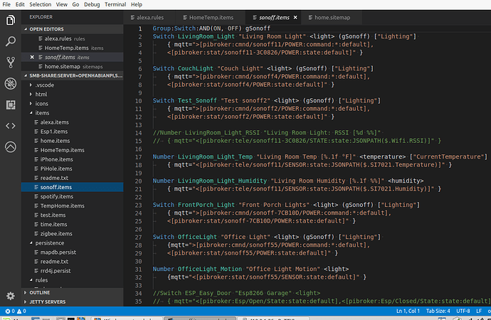

Another tip is take a look at installing VSCode with the openhab addon. You can change files and write rules easy. Here’s what it looks like

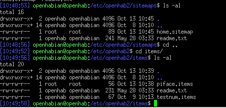

Can you post a picture of > ls -al /etc/openhab2
and ls -al /etc/openhab2/items
and ls -al /etc/openhab2/sitemaps

this is my new result. (it added an “r” on the file, i assume read)
file is still green and sitemap not yet visible in basicUI
the 2nd screenshot that u see is what happend, not sure tho when this exactly happend.
the 3th screenshot is cause i think there is a chance you might ask for it :stuck_out_tongue:

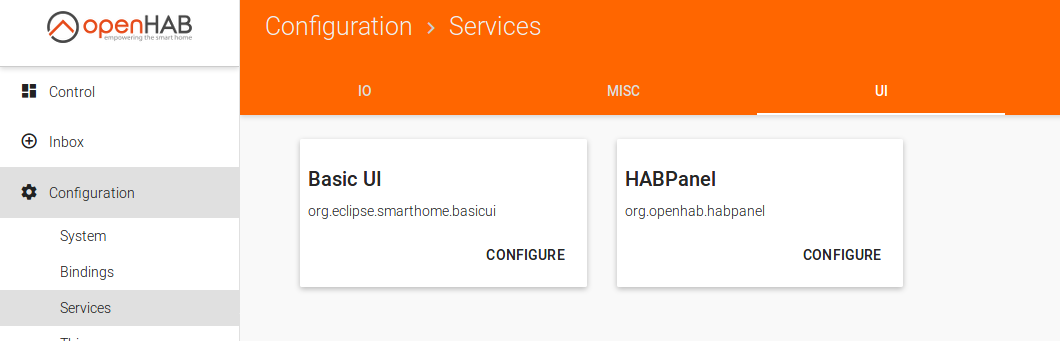

Please check that BasicUI is still installed by looking in PaperUI>Configuration> Services> UI. This should show all UI’s installed.
