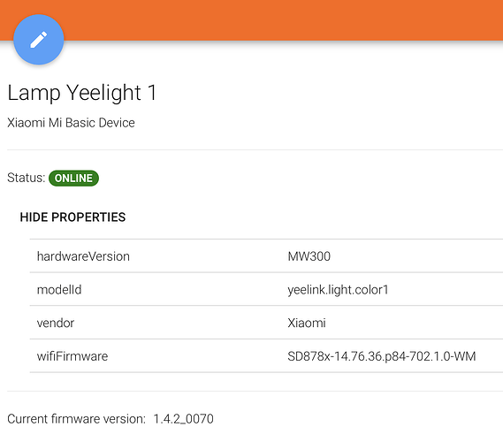

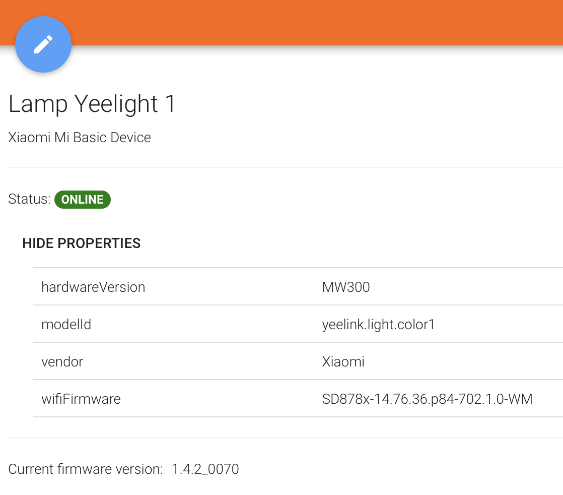

Ah, I mean the model Id like you can see in OH in paperUI.
Click show properties. as in below example
Ahh… Ok, here:
