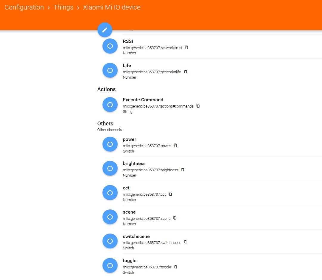

OK everything is working:
Sitemap:
Switch item=PhilipsCeiling
Slider item=PhilipsCeilingBright
Slider item=PhilipsCeilingCCT
Text item= PhilipsCeilingScene
Switch item=PhilipsCeilingSwitchScene
Switch item=PhilipsCeilingToggle
Items:
Switch PhilipsCeiling “PhilipsCeiling” { channel=“miio:generic:be858737:power” }
Number PhilipsCeilingBright “PhilipsCeiling brightness [%.0f]” { channel=“miio:generic:be858737:brightness” }
Number PhilipsCeilingCCT “PhilipsCeiling color temp [%.0f]” { channel=“miio:generic:be858737:cct” }
Number PhilipsCeilingScene “Scene [MAP(scene.map):%s]” { channel=“miio:generic:be858737:scene” }
Switch PhilipsCeilingSwitchScene “SwitchScene” { channel=“miio:generic:be858737:switchscene” }
Switch PhilipsCeilingToggle “Toggle”{ channel=“miio:generic:be858737:toggle” }

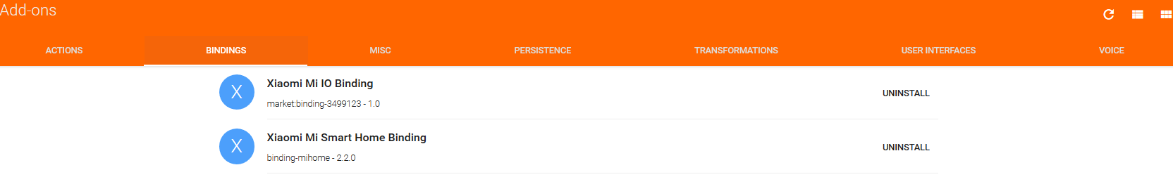

Hi to all, I’ve tried to binding this lamp but I cannot find it. If I add a new device I can only add it manually. I have tried all the combination (base, unsupported, vacuum) but I cannot binding this light.
I’have installed iot market but in binding tab I ca only find “Xiaomi Mi IO Binding” and “Xiaomi Mi Smart Home Binding”

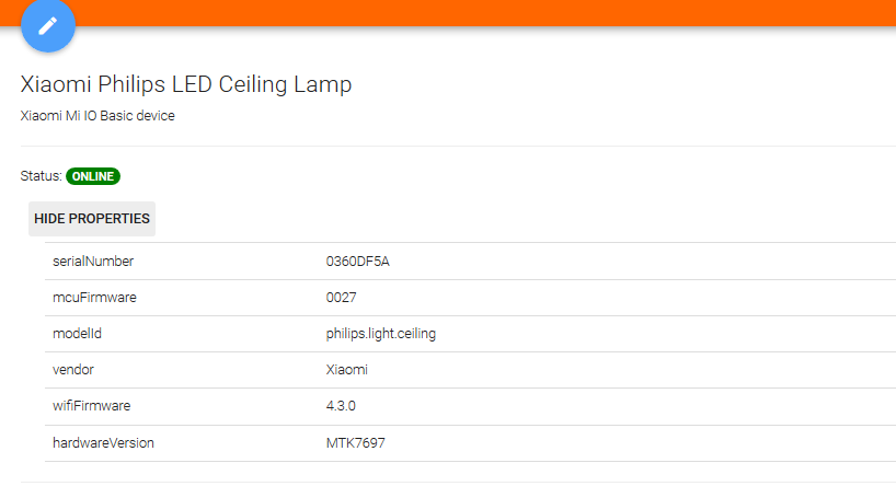

philipslamp

I have installed those bindings:

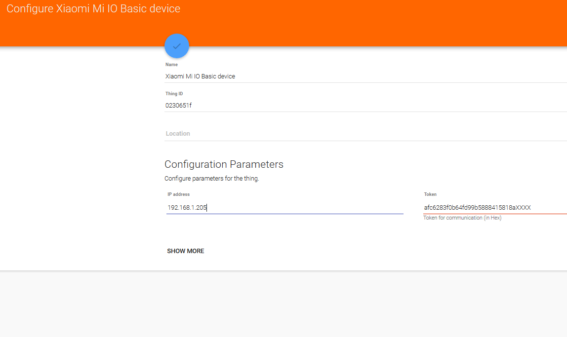

Hi talib can you send me a picture of the next step that you have done after installing that 2 bindings.

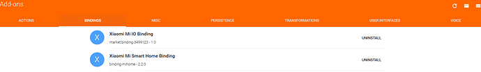

I also have seen a difference from mine, you have xiaomi mi smart home binding v.2.2.0 instead I have snapshot 2.3.0
Look at this:
hi talib, thanks for the picture. I have another question in the first of the two picture when you only insert ip address and token or do you insert other information? I’m asking this because when I put that information and add thing I don’t have the second picture with modelid philips.light.ceiling.
waiting for your kindly reply
Second picture is only like “additional advice”, I don’t remember what happend when I click “done” on first screen. Do you have correct token (do you know that you have different)?
