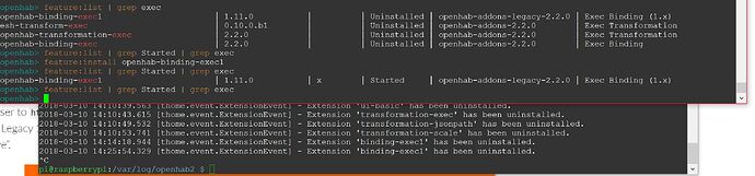

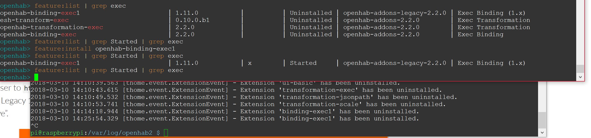

OK, this is really weird. So I check for the Exec1.X binding in Karaf console. Find it, install it. Then I check started features and it shows, but literally within seconds, as you can see in the log, it uninstalls itself? What gives here?
This is really weird. I see no other mention why this is happening.
EDIT: OK, I got it sorted and it was simple, actually. Essentially, I didn’t actually add:
