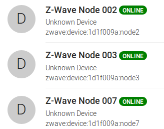

After having updated my Z-Wave binding onto 2.4, I’m not able to control my devices anymore. I then found the thread by @chris informing about the necessity to remove all items and then add them via the inbox once again and I did that, first trying to keep my controller as it was. This didn’t resolve it for me, so I also removed the controller (and all other Z-Wave things as well), uninstalled the binding, restarted OH service, installed the binding again. The controller is found and after having set the serial port, also the other nodes are detected. Nevertheless, all things remain unknown:
I’m using a range of different Fibaro products such as rollershutters, a multisensor, door/window sensors and switchable wall plugs that had all been working fine before. In addition, I’m also using a heater thermostat by Danfoss (LC-13). As you can see, it’s wired as well as battery powered devices, so I would at least expect the wired ones to be properly recognized rather quickly.

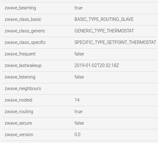

The device itself reports E5 (unable to connect to controller).

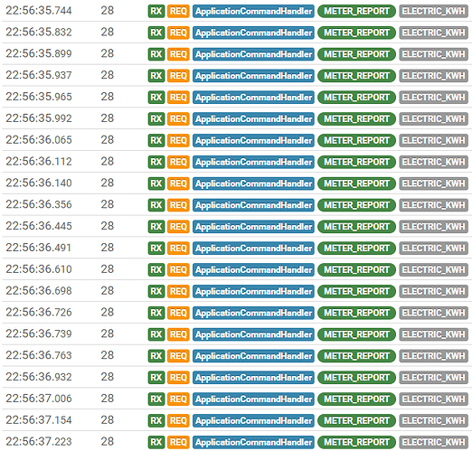

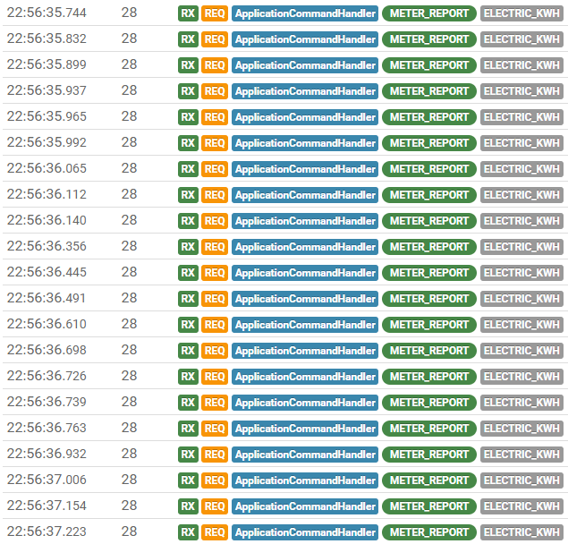

I could also see some changes of power consumptions being transmitted e.g. from rollershutters, so I’d assume things are generally working fine - It just seems as if the devices weren’t properly identified.
Would anybody have an idea on what could be the reason for this? As it’s gonna snow tomorrow and the heating still isn’t working in our livingroom, it would be great to get this sorted :smiley:

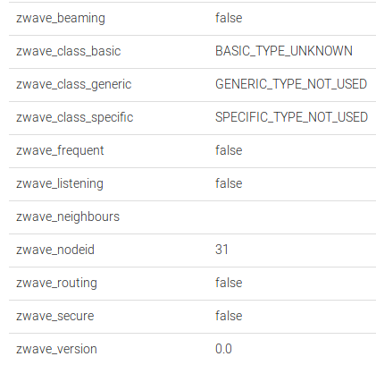

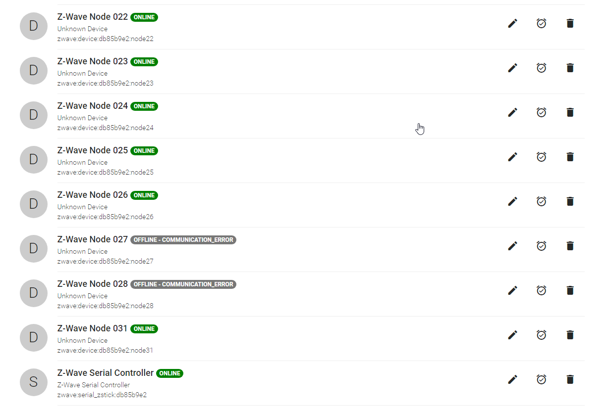

I have the exact same issue. I have a bunch of Fibaro zwave devices that are all recognized fine in OH1.8, but when I upgraded to 2.4 they all show up as unknown device.

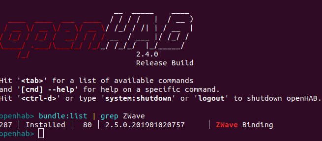

First thing I would suggest to update to the latest snapshot binding as it fixes a bug with wakeup that I can see in your log.
Generally, there shouldn’t be any issues - what do you see in the debug logs? Any clue as to what the devices are?
Most are Fibaro dimmers and some motion sensors.
The thing is, from the logs they look ok, see:

The issue is, from the Paper UI they all show as unknown device which means I cannot configure them and enable the channels. Or is there another way to configure?
This is a very short log, and it’s clearly not ok and indicates that the device has not completed initialisation - which is consistent with it not knowing the device type.

It can be inferred from the following
This shows the command class is version 0, which should not be correct if the initialisation had completed.
Unfortunately the log is way too short to be of any use - the binding itself has still not really initialised, let alone any of the devices. I would need to see potentially at least a few minutes of logging to see what’s happening - can you provide a longer log and I will take a look.
Please just use DEBUG - it should be enough. TRACE is very low level and will make the log a lot larger and harder to read.

In addition, I can confirm from Paper UI the command classes apparently having been properly determined while zwave version remains on 0.0:
This situation is present for all my devices - Wired as well as battery powered.

Karaf reports the Snapshot being in use:
Any suggestions?
Installed, but not Active. Since you’ve manually installed, you’ll need to manually resolve the dependencies… in this case:
feature:install openhab-transport-serial
That worked out fine, many thanks!
To me, the binding now appears to be working properly (see also within this log that shows the success immediately after having resolved the dependency as described by @5iver: zwave_log_250_initialstart.txt (347.1 KB)
All things remained unknown though. Thus, I’ve removed my thermostat thing again and re-added it via the inbox in Paper UI. See here for the log results covering some minutes of traffic: zwave_log_250_node14.txt (1006.6 KB)
Still, I cannot see any thing being properly identified. Maybe, someone can find a hint within the logs?
Thanks again!

The other thing I note is that some of your devices seem to flood the network. Possibly this is misconfiguration of the associations in the device (but I think it’s unlikely given the large number of frames), or it might be indicative of some other problem (maybe related to the above issue) if the controller is not receiving the data. In the event that the controller doesn’t ACK messages sent from devices, then the device will resend, and you can end up with multiple messages being received.
Above we see around 20 messages being received - the information is exactly the same in all of them, although about 2/3rds of the way through something in the control area does change and I need to have a better look at that to see what it means.
This same thing happens whenever data is received from lots of nodes, so my guess is some sort of controller problem. This isn’t something the binding can really influence, so I’m suspicious that there is something wrong with the controller. Have you reset it?
In the log here there is no data received from any device so I’m not sure what I can comment on here. There’s nothing especially wrong that I can see, but there aren’t any device responses at all.

Thanks, it was a matter of soft resetting the controller. Duh!
Many thanks, this also solved it for me! I could meanwhile get all my rollershutters running again and also the thermostat is working properly. After a while, the door sensor joined in as well. I’m only still missing the smoke detectors and trying to wake them up manually didn’t yet lead to any success, so I hope to be seeing them soon.
What puzzles me a bit is that for one of my wall plug switches (an AEON Labs ZW075) is constantly writing this message package into the log:

I have an equal one at another place as well that doesn’t flood so much into my logs. Both of them are switched on with a consumer being switched off, so I don’t quite understand why only this plug is constantly publishing 0 watts to the controller… Everything works fine in that regards though, it’s just the flooding of the logs (and maybe also the network itself, which makes me afraid of further issues coming up in the future). Maybe, someone has an idea of where to configure this? I’ve checked the properties in Paper UI, but they’re the same for both plugs.
