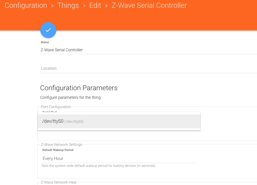

I am running openhabian on an older RPi 2 something and I’m trying to get my Aeon ZWave Stick set up and talking to the zwave devices. I’ve added the Thing for the Z-Wave Serial Controller, but it says the Status is OFFLINE - BRIDGE_OFFLINE Controller is offline. I click the pencil to edit this Thing and the Serial Port shows the only selection is /dev/ttyS0. However, in the openhab.log file, I see this:

Which I think means the controller is connecting to /dev/ttyACM0. Using ps aux, it looks like the openhab user is running the openhab service, so:

Edit ttyS0 isn’t even a thing:
[18:37:25] openhabian@openHABianPi:~$ ls -l /dev/ttyS*
ls: cannot access '/dev/ttyS*': No such file or directory
[18:37:31] openhabian@openHABianPi:~$

So my hunch is that the controller comes up fine on /dev/ttyACM0, but for some reason the PaperUI doesn’t let me select /dev/ttyACM0 as the serial port, so openhab can’t find the controller:

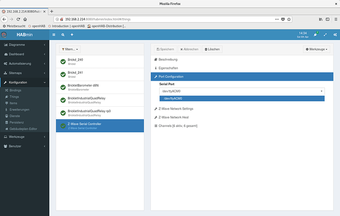

And rebooted the pi. But the binding doesn’t show up in PaperUI. Since @sihui seems to be using HABmin, I thought that might have a snapshot somewhere or something, but it also does not show the zwave binding as installed and does not show me a snapshot number.
